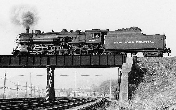

This is probably not useful at all, but one thing I found is that it looks like NYC was ordering these same tender trucks on its earlier Alco 4-6-2s. No one else was, even MEC on its order of 4-6-2s prior to yours (edit: it looks like IC ordered them too). Not sure if any detailed drawings survive anywhere, or a whole locomotive, but NYC had so many of these and was a much larger company.
https://www.railarchive.net/alcopacifics/
Here is a photo that shows the brake cylinder, though the truck design is a bit different from yours:
