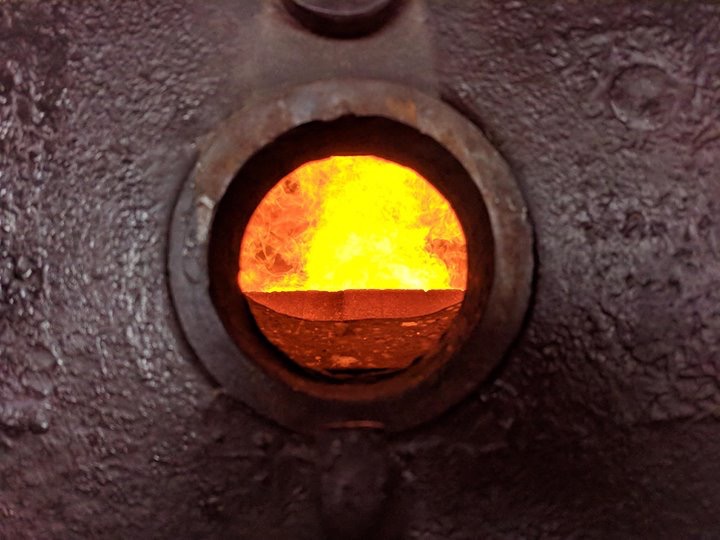

Just got confirmation that Santa Fe 2926 has a fire in her for the first time in 60 years. Congrats to the Albuquerque group for restoring the world's largest 4-8-4 to steam!

2926 is a project that's been going on so long, I think it surprised people to know they'd finally lit a fire. You can't help but smile at the idea that all that work has finally paid off.
Until I saw another photo elsewhere online, I had no idea the pistons weren't in place and the fire was raised just to test the boiler (I assume) and it won't be able to be moved anywhere yet. I'm sure there's a reason why they did that, but I'll be darned if I know what it is.

You do this to blow out all the steam passages, with full boiler pressure, to knock out any scale, forgotten bolts, squirrel nests, missing volunteers, etc, that might be in the system. You would rather blow this stuff all over the tracks, instead of into your valves and pistons.
I believe there are some videos of when we did this on the 611 that first fireup day.
