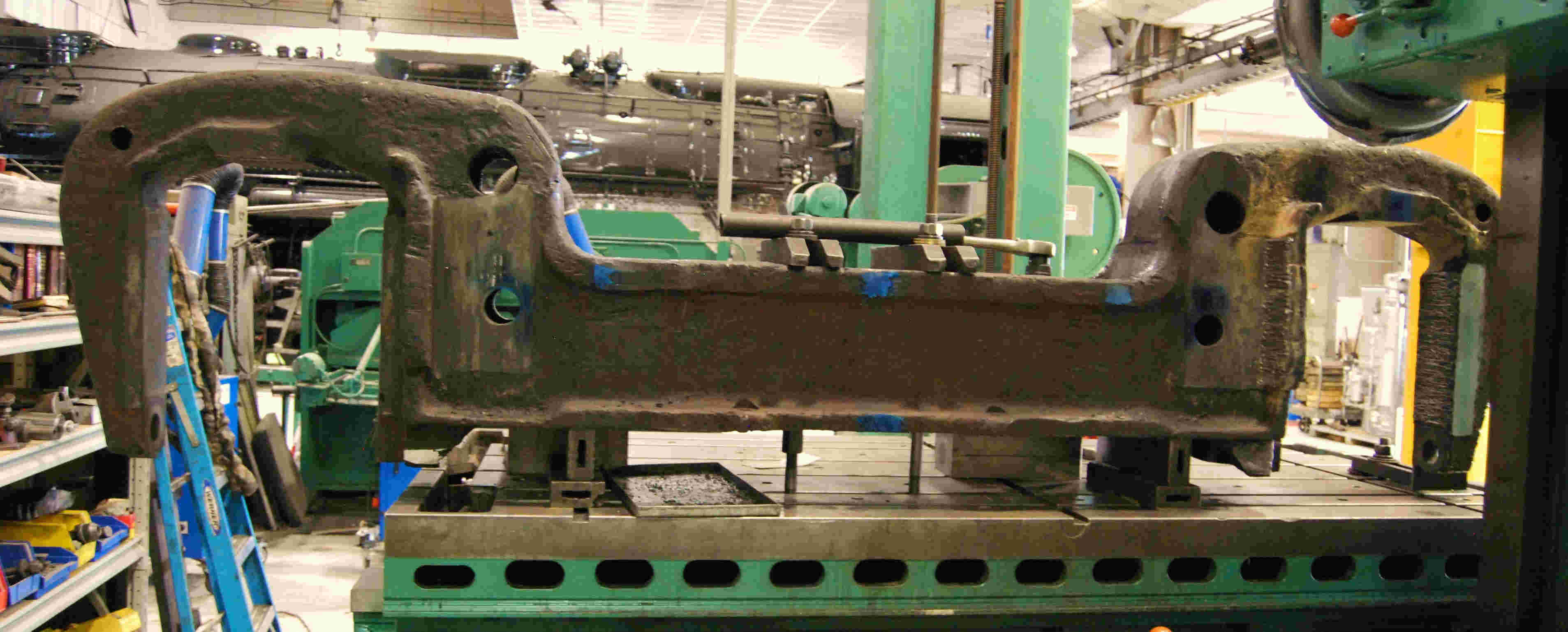

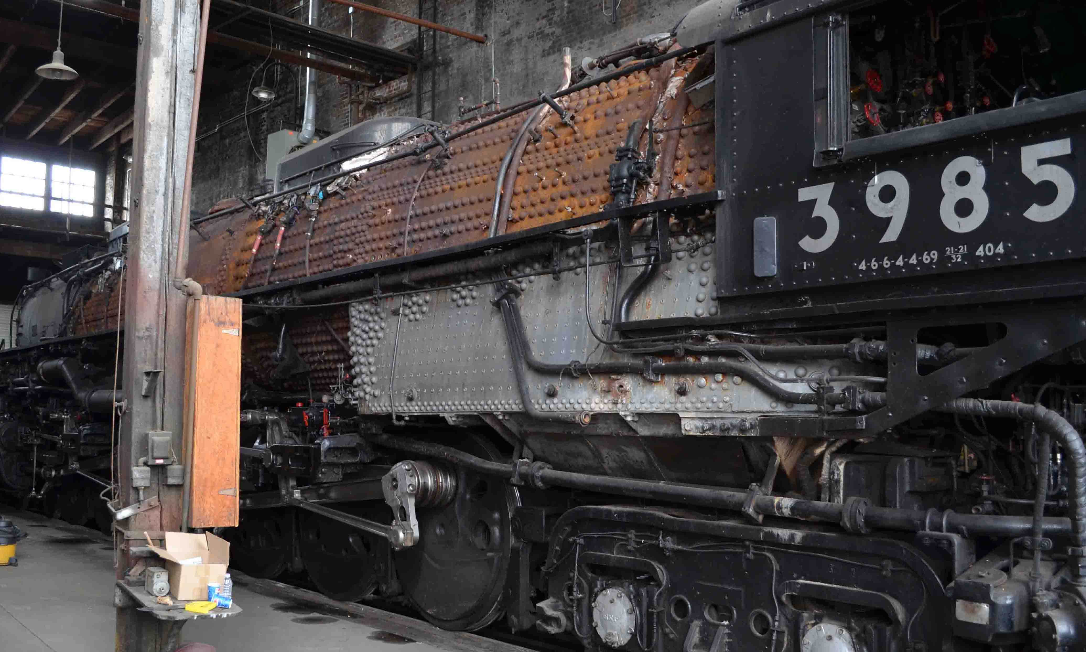

Looking through some of my photos it looks like the super heater tubes were removed in 2010 and replaced by 2012. Checklist in 2012 shows there was a hydrostatic test done. In 2010 there was also much work done to the front truck in regards to welding and machining the front wheel liners. Photos are of low quality to meet the requirements on this site but I think you can see everything. Zoom in on the checklist of the work scope of the 3985.

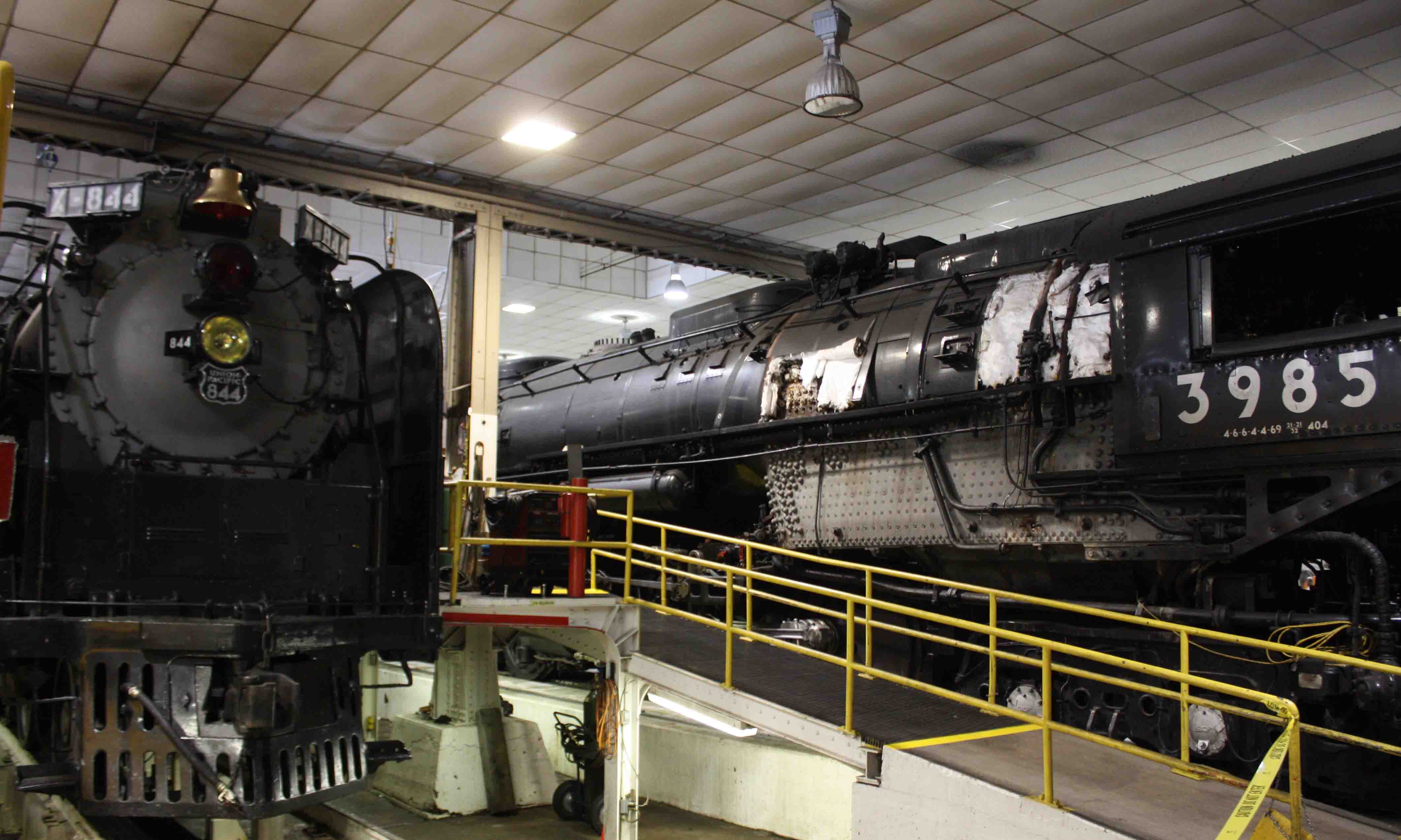

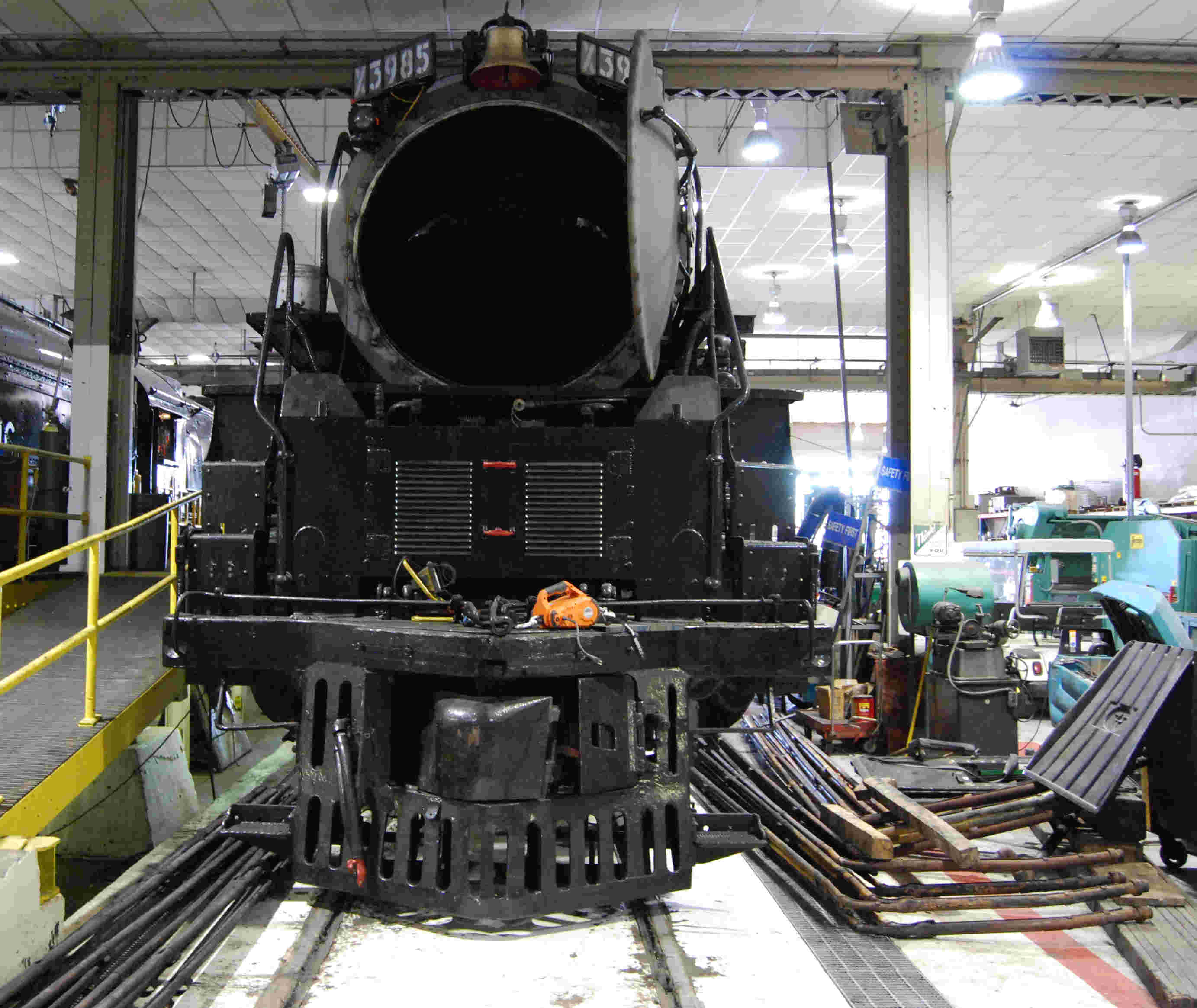

After looking at my photos over the years in the steam shop I would conclude that the work list was likely the #844 as the super heaters were removed from the #3985 in 2010 (same year the #3985 stopped running). Everything from the work list is from 2012-2013. Normally these papers are taped to the board specific to the locomotive being worked on. In this case the papers were taped to the #3985 board. I included a photo of the #844 board and it is pretty hard to mistake the two boards.
Work did not stop on the Challenger in 2011. I Included photos from May 20th, 2012 showing the #844 and Challenger side by side in the steam shop. The #844 had yet to go into overhaul as it still had the July, 2012 excursion to complete. The majority of work for the first half of 2012 would have gone into the Challenger. I posted a photo of the Challenger in May of 2013 showing all the boiler jacketing removed and now sitting in the old roundhouse. Work likely stopped on the Challenger in late 2012. The earliest work shown on the confirmed #844 work list is November of 2012.
The Challenger would have had roughly two and a half years of work done to it. I have no idea why those photos are so large!
