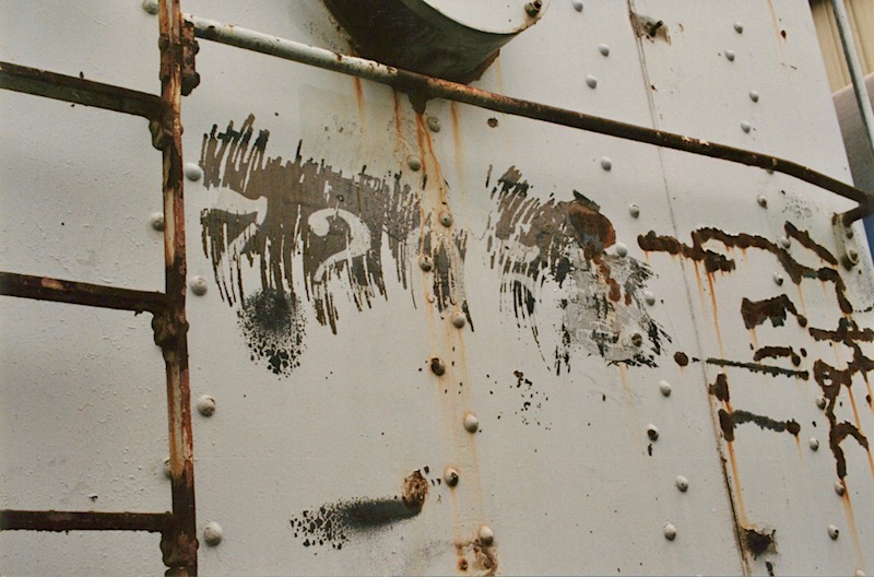

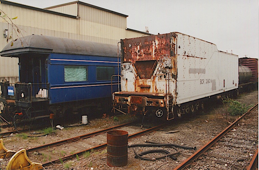

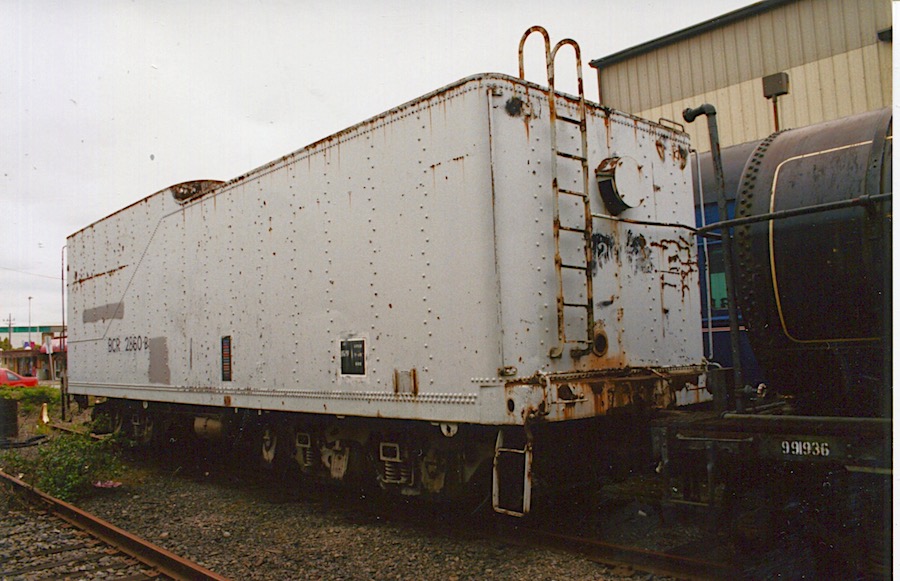

Looking for information on this tender. BCR acquired it shortly before CN took over.
Labeled 2860B.
Was to be used as a Canteen car for the Royal Hudson. Seen here at the N.Van steam shop.
I'm told it was off one of the last SP Cab Forwards. Under the paint it seems to be 7205?.
Would anyone know what engine this might have been off of..?
It's a big tender. Towers over the BC private car fleet.

Some research shows that the Southern Pacific had a rotary snow plow with the number 7205 back in 1957. Could this tender be from this out plow? During a rescue of a SP train up on donner pass, SP 7205 snow plow and SP 4245 (mallet) tried to pull a stuck train from the snow. (http://ctr.trains.com/railroad-referenc ... treamliner). This could be the tender from that rotary snow plow.

The only listing I can find for a tender numbered 2860B is the one currently at the Cranbrook Railway Museum, which actually WAS used with 2860 for quite some time. That tender was originally from CP 4-8-4 3100.
But this is definitely a different tender. In addition to the timeline problems this tender's front section is not raised nearly as high.
When were those pictures taken, and where is this tender located now?
I see it has a regular drawbar and knuckle coupler at the front end, could the 7205 be all or part of a subsequent number after it was converted for MOW service, and have nothing to do with the locomotive it originally came from?
That would be correct if the tender is from a Southern Pacific cab forward. Accroding to Harlan's book on SP cab forwards, the highest number used was 4294, the last AC-12, which is now in the California State Railway Museum at Sacramento. I doubt that SP had any steam locomotives numbered in the 7000's.

The Southern Pacific rostered tenders separate from locomotives and frequently exchanged tenders; and maintained record cards documenting assignments by both locomotives and tenders with dates on and off.
If assigned as a tender for a snow plow, wreck derrick, etc. it would be a four digit number with a letter (most likely "A") as the fifth character. Looking at the photo the numbers are not centered under the light indicating there should be one more character.
If no one shows up with additional information for this SP tender, perhaps the SP Historical & Technical Society and help you direct you and your inquiry to a source.

The photo's were taken at N.Van in the late 90's. When CN took over, the BCR steam program was dismantled. The tender went to the Squamish rail museum. It remained there for a while, until it was cut up and sold for scrap.....
Talked to a California railfan many years ago, who said it was off a Cab Forward that had been in a wreck and the engineer had died. I had discounted his information, but maybe it being used as MOW equipment, was not too far wrong. It's use behind a snowplow, would fit the narrative.
Definitely not the one sent to Cranbrook.

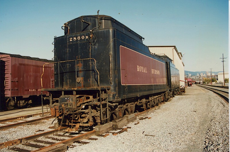

Here's an interesting shot. The 'other' 2860B tender you mentioned.
25 Feb 1991. North Van.
Note the front wheel sets have been removed, and the truck frame is sitting on wood blocks.
Wonder if that was prep work for the run to Cranbrook.? Will have to ask some knowledgable people.
BTW, I see what you mean.
If you remove the oil bunker, at first glance, the two tenders are very similar.

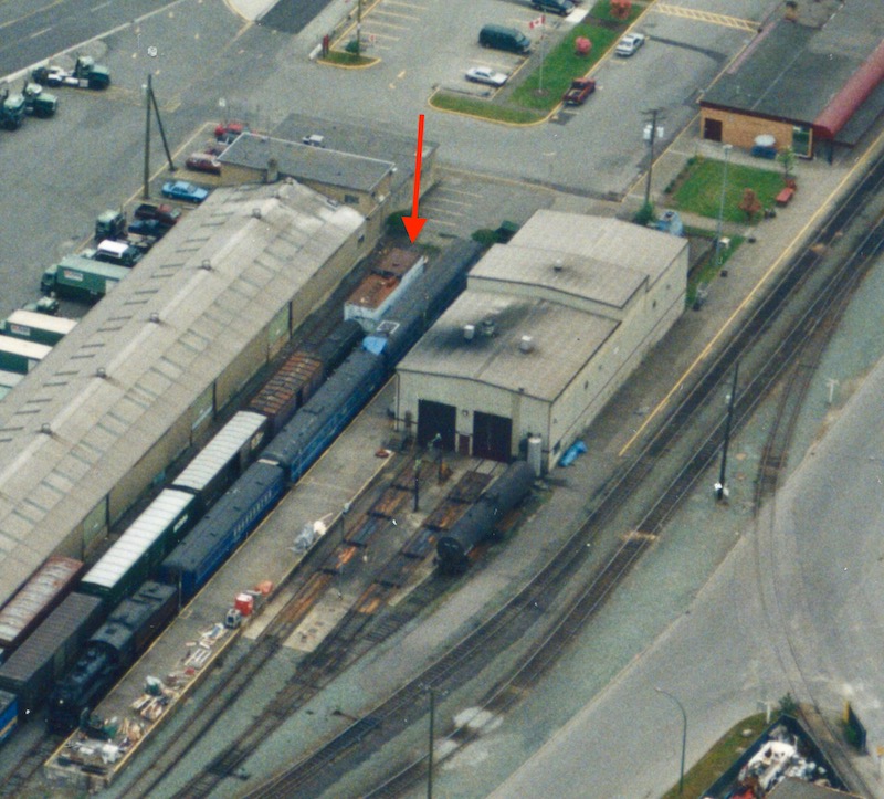

You could see it from Space.....well a Cessna 172, anyway.
A matching shot for the other ones.
Shows the Steam Shop, next to the N.Van Station.
And 3716 coupled to the BCR Executive Car fleet.
