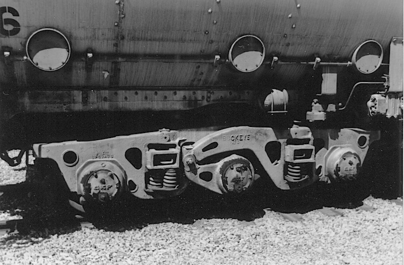

BigBoy 4023
Robert,
Took awhile to understand how important support tenders have become.
In today's world, few steam trips could happen without them.
Added this Ogden Turbine Tender... 6-wheel Buckeye truck, to the conversation.
Equipped with SKF bearings. It's quite a piece of gear..
Glad to hear it's been saved.
Would like to add a few comments, if I may.
1) Nothing wrong with plain bearings...If you know how to look after them.
Nobody does on the big roads, so it makes sense not to run them there.
This is where the the museum/heritage lines play a big part.
Teaching a new generation how to safely operate the plain-bearing fleet.
2) Roller bearings have issues of their own.
Have been told by reliable sources, who work on this stuff.
When a roller-bearing on a main axle fails ..it seizes, and sometimes...twists the driver right off the axle. Think about the consequences of that for a moment..
Dennis
