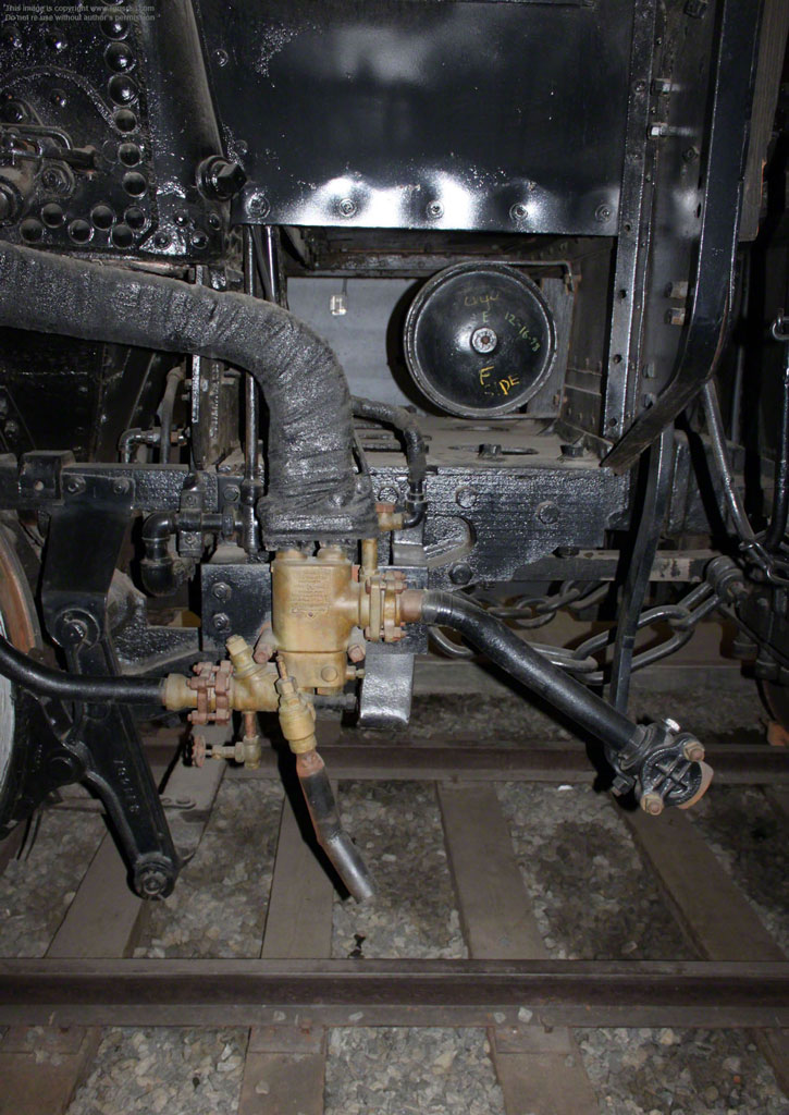

I am looking for preserved Hancock H-N-L Inspirators.
The K-28 and K-36's all have K-N-L's
I think there is one on Chicago North Western 444 at the Forney Transportation Museum.
I need detailed photos and dimensions so I can build one for a 1.6 scale model I am working on.
Thanks
Tim Meyer

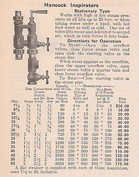

Not sure how useful this is, I found it here: https://www.smokstak.com/forum/showthread.php?t=96563
