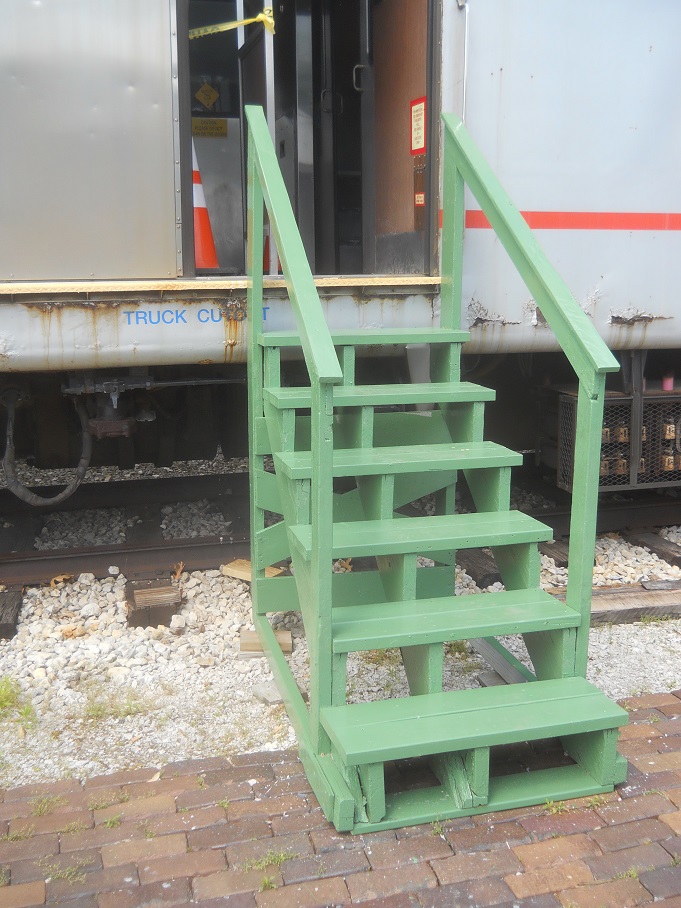

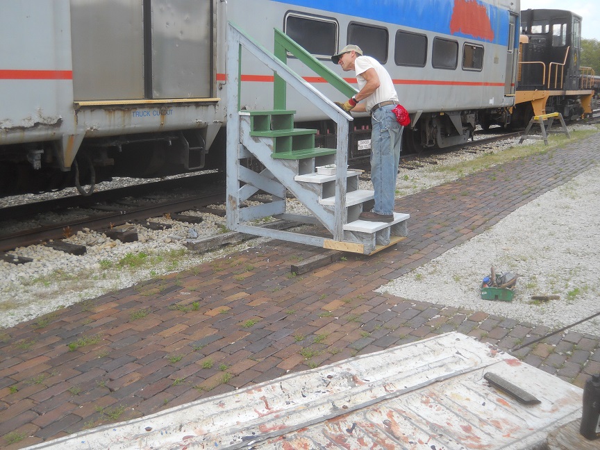

After painting our NKP baggage car, Penn Central boxcar, NKP gon, and other pieces of museum equipment, Mark found an old can of oil based paint. He estimates the can is at least 30 years old and after struggling with the rust on the lid, was finally able to get it open disclosing a heavy skin on the top. After working through that, he discovered that there was still paint at the bottom. He mixed it and found that it was good enough to put on the stairs leading into one of our display cars. The motto might be to "never give up on an old friend" (or can of paint)!

 Post subject: Re: Old paint gets used by not so old painter!
PostPosted: Sat May 25, 2019 9:44 pm
Short follow up to the my original posting. A photo of the finished painted steps is attached. The paint appears to be tight. Did not scrape off a spot in an inauspicious location to see if it might be "a sticky mess under the dry top" as Doug suggested might be the case. Time will tell if it holds up. As to Charlie's question about the age of the steps, they are older than I thought. They have been repaired a couple of times as Bob Jachim advised when I asked him. Bob had recently repaired them to remove old deteriorating parts. It's the old story about "my great grandfathers original axe" (and its many replaced handles) but this in the form of a set of stairs. My "guestimate" might be about 20 years old. Like many museums, Hoosier Valley reuses whenever possible.
