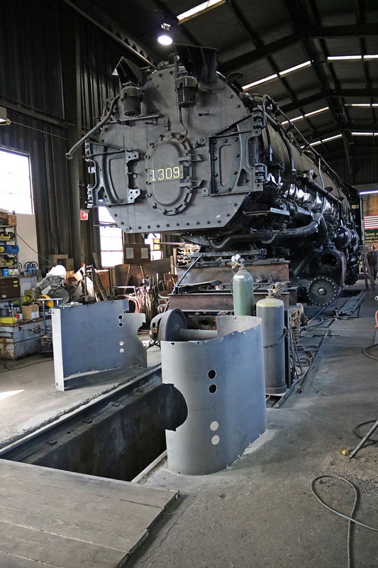

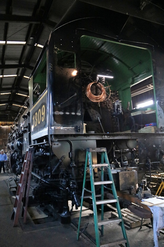

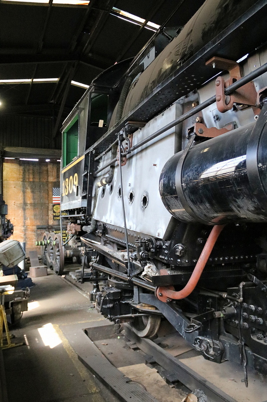

Earlier this week I asked for an opportunity to photograph the progress of Western Maryland Scenic Railroad #1309. This past Saturday morning the GM of the WMSR met me at the Ridgeley Shops to give me that opportunity.
A small crew was working Saturday on air brake plumbing for 31309.
I was told the locomotive is being readied for re-wheeling in the coming month. All of the driver's are in the shop either in front of or behind the locomotive. Pistons are in place. Noticed that a lot of the spring rigging is in place, along with all the lines coming off the lubricators. Both injectors are plumbed. Obviously missing is the air compressors on the smokebox front, but I would assume they are being kept off the locomotive until after it's lifted back on it's wheels.
I was told they are "on track" (pun) for operation in July.
Hard to take photos of such a large object in the tight confines of the old Western Maryland Carshop but here's 3 that I will offer up.
They are also working on the finishing touches to a boxcar with a large diesel generator skid unit installed that will become their new power car. The funding for Power Car came from a local business dedicated solely for that project.
Tim W.

Were the firebox sides jacketed before, or is that new?

"Were the firebox sides jacketed before, or is that new?"
There is a builder's photo at the end of Alfed Bruce's book on the American steam locomotive, but I can't find a Web version of it that I can post here. I recall that as built, the firebox legs were unlagged but overfire jet apparatus was provided.
There is a picture of 1309 in regular operation with unjacketed firebox here:
Image I don't know if the 'smoke consumer' system would be installed on the restored engine.

Another photo, from Trains magazine, with the engine looking very nice for the Chicago Railroad Fair. The firebox looks unlagged in the photo. C&O practice was to keep the firebox open, while WM lagged the boxes on much of its power.

I'm guessing the overfire jets are going back on...judging by the holes in the firebox jacket. I'm used to narrow gauge steam....so the idea of jacketing a firebox seems a little silly. We just paint ours.
I do like that photo with the green boiler jacket. Sharp looking engine
