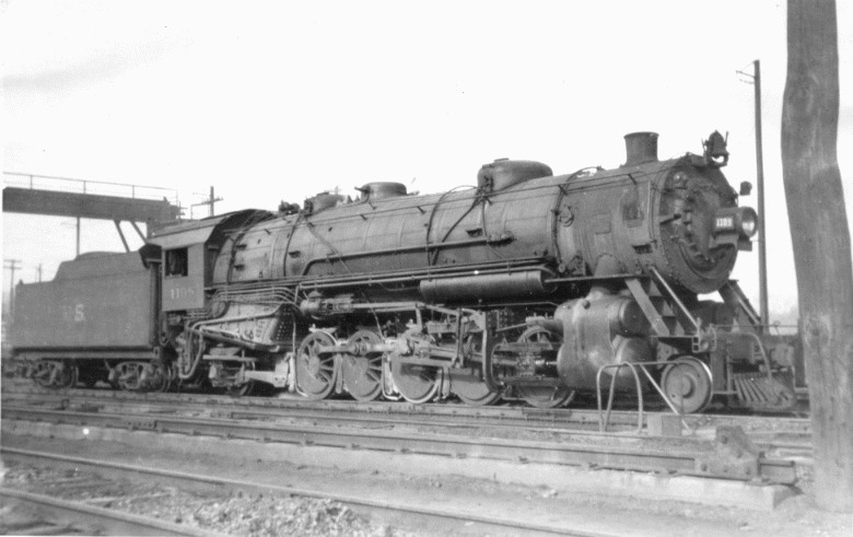

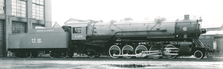

So I've been doing some research into the Boston and Albany's Z1 class of USRA light Santa Fe engines for a private modeling project, but looking at the builders pictures it appears the smokebox was a dark grey, while the rest of the locomotive appeared to be a lighter shade of grey. However, looking at some in service pictures I've managed to dig up it almost looks like the whole locomotive is the same dark shade of... Well, whatever the color is, it's dark. To the experts, what's the deal here? I've attached images I've tracked down through the internet.

What you're looking at in the builder's photos is typically a locomotive that has had its paint altered for the photograph. In the period you're looking at, at Baldwin the practice was to paint the engine with a light grey paint on certain parts, like the boiler, cab, tender, and drivers as seen here. This was to make details show up in shadows better, to hide the dings, dents, and waves that would be in the thin metal of the boiler jacket, and also to provide a sort of "dress appearance" for the photo.
After the pictures were taken, the engine went back into the paint shop to have its delivery finish applied. For these USRA engines, it likely would have been black. Interestingly, in this period the standard color at Baldwin, the default choice, would still be the olive green with aluminum lettering that had been used for quite a few years, and would still be in use for some time later.
There were variations at other builders. Lima used the grey for a time, but later changed to just a flat finish that would later be replaced by the glossy coat that was normal for delivery. This was usually just on the right side of the engine. There are photos from Lima of both sides of the same engine at the same session, and the left side is shiny.
The smokebox and sides of the firebox were usually not jacketed, and could become hot enough to burn off any standard paint. What was normally used there was a mixture of graphite and oil. In this period this was a home mix, and the color could vary from a relatively light or medium silvery grey to a near black color. It would not dry as such until the engine was fired up and got hot. This is often available as a commercial mix now.
Of course, the whole engine would become a sort of charcoal grey after time as it got dirty. The dirt itself was a mixture of soot from the smoke, dust from the air and also from sanding, oil and grease on the running gear, and lighter stains from mineral deposits in the water that would show up anywhere there was some sort of leak or point of exhaust for the steam, such as around the whistle or the safety valves. There was also fading of the paint from the sun and from heat. In some cases, you also had rust deposits as some paint or graphite was worn or burned away.

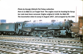

Hi
The B&A 2-10-2's before they when to the Canadian National they were also assigned via a transfer of power by the New York Central to the Big Four. They were transferred to the Big Four the CCC&St.L on March 1926, they were later sold to the CNR, August 1928.
Once the CNR railroad received the locomotives, their number got changed, received either new or modifications to the locomotives, to meet the requirements by the CNR.
The B&A 2-10-2 's were built to the USRA design, by America Locomotive Works or ( ALCO).
Here is a photo which is part of my slide collection, taken by George Hildreth, no date on the slide when taken.
File comment: The photo was taken by George Hildreth, Pat Fahey collection.

Dylan, the photos you have are for the engines as delivered under United States Railroad Administration authority. When they would have been repainted, they would have had standard Boston & Maine lettering style, which would have been essentially the lettering practices of parent road New York Central.
However, it's important to remember that the NYC changed locomotive lettering around 1940 to a sans-serif style called "Century." Prior to that, the lettering would be a variation of Railroad Roman, as seen in the examples below.

You do bring up a good point on the paint scheme, but that leads to another question... Where the B&A, and by extension the NYC, held onto those Z1s for what I'd consider a short period of time (about a decade) would they have bothered to reletter the tenders? Every picture I've seen showed those engines in B&A service, still with the USRA lettering. Where I'm shooting for that era, I want to make sure it's accurate. Railroad roman lettering is readily accessible, but if need be I can have some decals made up...
