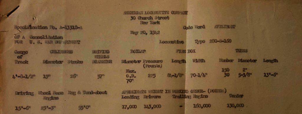

I have been researching USATC Consolidations for over six years. As I stated a few posts up, I had become convinced that "S-160" wasn't a valid designation for the design as it was not used on any documentation. Yesterday I found a source that proved me wrong. The attached comes from a nine-page specification for the locomotive prepared by ALCO. It gives the "locomotive type" as "280-S-160." A similar specification from Baldwin gives the class as 280 19 S. No designation is given on the Lima specification. Although S-160 only applies to locomotives built by ALCO, at least there is a source showing where it came from.

I see a locomotive weight of 160,000 lbs. Probably where the designation came from.
