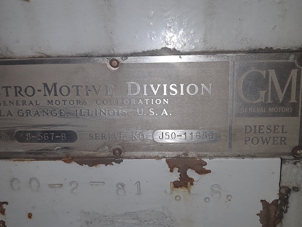

I’m looking for information in regards to EMD SW8’s with the 567B engine. In particular this question is going to relate to the former New York Central SW8’s that were acquired by Conrail.
I’m involved in a museum project that is in the process of acquiring an EMD SW8. I’ll be happy to discuss this project more later, as I think many will be interested in it.
This SW8 was built in February 1953 for the New York Central as part of order #4144 and carries serial number 16195. It was NYC #9620 and became Penn Central #8620 and subsequently Conrail #8620.
After Conrail, the locomotive has been in numerous industrial switching operations in Eastern Canada.
It was built with a 567B engine. We understand that Conrail did significant upgrading to their SW8’s and I’m wondering if anyone knows to what extent did Conrail rebuild the prime movers in these units and did they receive the conversion to 567BC specifications?
I’m including a photo of the engine that shows its EMD tag and serial number. Below that tag is a stamping that reads: C0-2-81 J.L.S.
I would assume the 2-81 means February 1981 and the J.L.S stands for Juniata Locomotive Shop? I have no idea what the C0 means, but I’m wondering if the C at the beginning of the stamping is in some way referring to 567C specifications?
The locomotive did receive other major upgrades from Conrail as it’s equipped with a 26L brake and MU capability was added. We however, can’t find any info (yet) on the extent of the engine overhaul it likely received as part of this upgrading nor what the work in 1981 by Juniata Locomotive Shop would have involved.
The locomotive is in good mechanical condition based on very preliminary inspections so far, but myself and others have not yet been able to see it as it’s on the other side of the country, so I don’t know if the original 567B was upgraded to C specs or not.

Conrail was not consistent with their switcher overhaul program. Some locomotives with B blocks received BC engine upgrades but retained their original wiring and control stands; some retained their B blocks but were otherwise completely rebuilt. Generally speaking, most of the engine upgrades I've seen have the badge plate altered to show "BC".

If the engine is shut off, and you can get permission from the current owners, open one of the upper inspection covers (rectangular hatches on engine sides).
If there is a water pipe running down the length of the airbox, with jumper pipes connecting this pipe to every cylinder, it is a BC. If not, it is still a B.

Thank you. This is the exact sort of info I’m looking for. I wasn’t sure if they had a standardized rebuild program or not.
Further research indicates that the badge plate on the current engine block starting with serial number J50 means October 1950. With this SW8 being built in Feb 1953, would indicate that it is not the original block and Conrail changed the engine when rebuilding. However, the question remains was it updated to BC or not.

The first photo showing a B style air-box with internal water header with nothing to be seen. The second image is a C, but a BC would mostly be the same. IIRC, if it's B, or BC it will have squarish (with rounded corners) inspection hatches on the block; and an original C would be circular.

This photo should answer your question, it's a B block, no modification to BC.

You're part way there with the code stamped on the block. It translates to "Complete Overhaul-2/1981-Juniata Locomotive Shop.
Our 8619 got the "CO" in 1979. Can't remember the month. The prime mover is a B-block. The 8619 was completly re-wired as well at that time and retains its original cab inards (barrel control stand, #6 brake, etc.)
