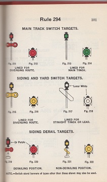

That was my thought as well. I just wanted to make sure I didn't miss something. I believe somebody soldered the UPRR tag on a SOO lamp after the fact. The solder job is less than professional. Certainly not what I would expect to see from a RR signal dept.
Pat,
That is very interesting info, and exactly the opposite of what I expected. Do your rule books happen to mention in what application those indications were used (ie. main track switch, siding, or dead end siding, etc)? Could you possibly post a picture of the page from the rulebook?

E -
I'm not sure how Mr. Fahey is reading his rule book, but modern NYC switch signals have always been green/red for main track and white/yellow for other than main track (from the 20s on, IIRC). Green and white for normal position, red and yellow for reverse.
I don't remember off hand who used green and white as a pair, although I have seen quite a few switch lamps with green day target and green lens paired with yellow day target and lunar lens at auctions. There are plenty of RRs that used white and red paired, with various target shapes.

Hi All
The rule book that TrainDetainer did post is the same rule book, that I also own.
Yes, I do admit and agree with the last post by TrainDetainer, about the switch lamp lenses, Green on White or lunar lens.
Yes, you would think, that the green lens would be RED, but sometimes the railroads change things for some unknown reason.
So it could be possible that off the straight track, or yard, lead, that the Green Lens could also mean, that the straight or yard lead, track, also lined for the main track, instead of a siding.

I did manage to find an article about NYC signals that stated their predecessors used lunar for normal route and green for diverging (or caution) sometime prior to 1912. A copy of the 1912 rule book seems to be the earliest to use red/green and yellow/lunar indications. I'm not sure when Adlake started making the square top lamps, but I don't think it is that old. I could be wrong though.
E
