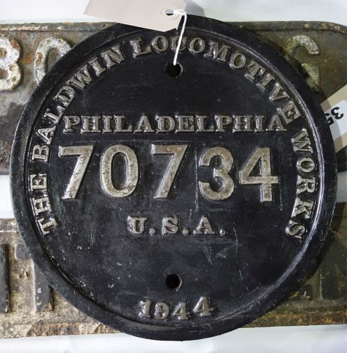

The attached photo is of a much later plate. I was told it had been on a Russian locomotive. Notice the poor alignment on the numbers. I suppose the misalignment could suggest a fake, but I suspect that they used a master pattern and applied different numbers for each locomotive. For some, the numbers were applied more carefully than for others.
Oddly, when looking for the correct design for the builder's plate for Alaska Railroad 557, I carefully searched several times through the drawing index for the group of 180 locomotives built under the same order. The builder's plate was about the only part for which I couldn't find a listing or drawing number. The other cast plates were listed, including the U.S. Army Transportation Corps I.D. plate with the USATC road number.
