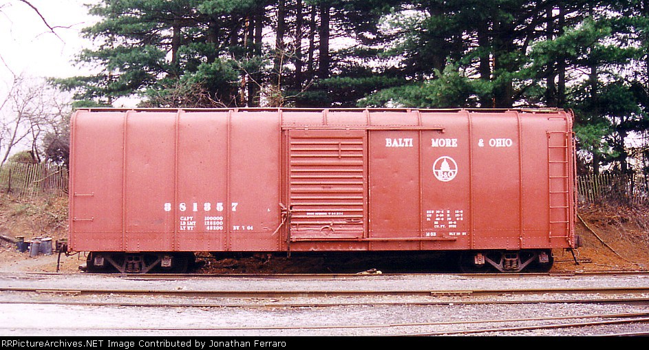

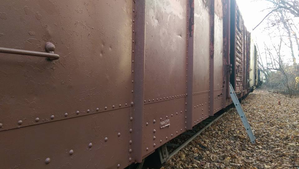

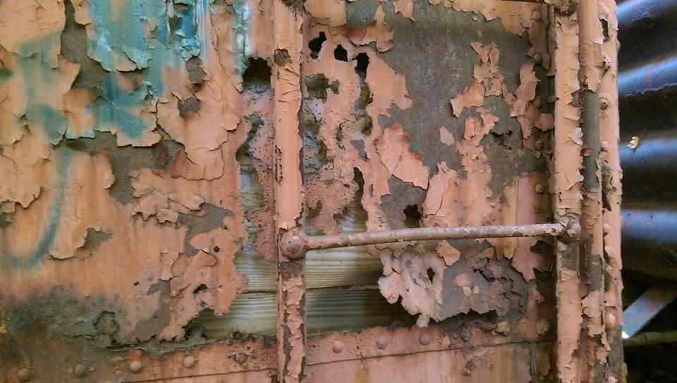

Hi everyone,
For the past year I've been slowly but surely working on ex-B&O 381357, later B&O/Chessie System 910510. The car is stored on the Wilmington and Western Railroad on one of our sidings. It is fenced in and monitored. Saved in 1983 by a former W&W volunteer with the intent to restore it and have it be used as a historical piece on W&W trains and as part of our "rolling museum" fleet of equipment.
In 1991 he began restoring the car piece by piece. Little to no metal work was needed. Everything was cosmetic, with the exception of the roof walk, which had rotted away after 54 years of sitting outside. By 1996 the car was painted, lettered, and technically "In service". The W&W used the car for storage of crossing lights and equipment. After an unfortunate turn of events with the owner, he had to move a good distance away from the boxcar and had little to no way of working on it or maintaining it. November 28th, 1997 (6 days after I was born) was the last time the car was used. A private charter with MSC 98 and an Erie 2 bay hopper.
18 years later, she sits on a storage siding between some trees and a pole barn. The metal is showing it's age in some spots and a possum is living in it. The Sears exterior house paint is peeling off in a most unfortunate way. I took on the project by myself, using my funds and equipment to restore the car a second time around. The railroad made it clear they want nothing to do with it, and thats understandable. I use two generators and propane torches to get any on site work done. Everything else is done at my shop at home.
Attached are a few photos to show what's going on at the moment. Not a whole lot is done, but it's a start. Side A is halfway primed and ready for paint. Side B is being prepared.
Also, if anyone has any information on this car or can reference me to someone who has the big B&O lettering from 1962 until the end, please do so.
Thanks,
Christian B.

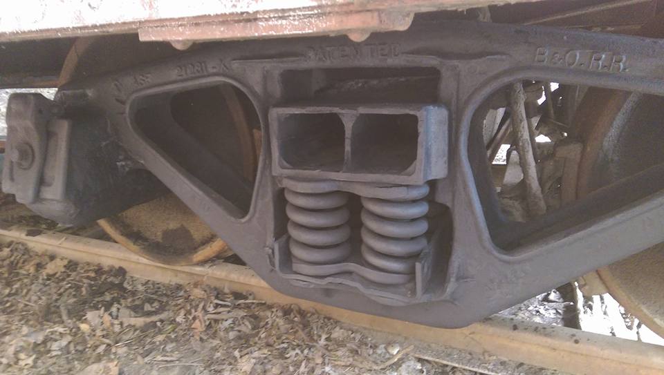

The undercarriage of the car provided me with a shady area with somewhere to sit (mud) during our recent heat waves. All of the trucks have been painted flat black (for now) to help keep anymore mud and journal oil and debris from covering them once more. All of the journal boxes were jacked up, inspected, and cleaned before the project went any further. Melted brass and a torn axle would've slowed down progress A LOT...
The focus this week is the brake system. I've found a working replacement for the AB valve that currently hugs the car. Getting it inspected and finding new studs for the brake pipe should be the hardest part of putting it back together. Hopefully some air and adjusting will result in a good brake test.
As stated before, I work at the pace my job and life allows me. I haven't spent any time this weekend working on it because of the railroad needing help and finishing my personal "to-do" list. Time is a valuable thing, especially when winter is approaching.
Attached is a photo of one of the cleaned and painted trucks. Excuse the quality of the photo.
Thanks,
Christian B.

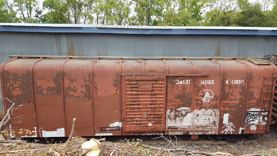

The railroad cut down 50 years of growth around the resting place for the car to make way for storage units. This is the first time I've had a real look at the whole car as it sits. Probably the first time this side has seen a decent amount of sunlight in 20 years.
- Christian B.
