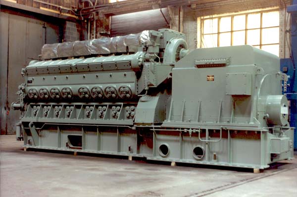

 Post subject: Re: “Urban exploration”- underground Chinese steam shop
PostPosted: Tue Mar 12, 2024 5:41 am
Posts: 2130
Most military style "hardened" facilities would have an equally secure power generating source. The only power plant supplying the tunnel complex was external? That seems contradictory to the purpose of putting the repair complex underground.
PC
