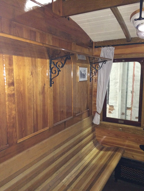

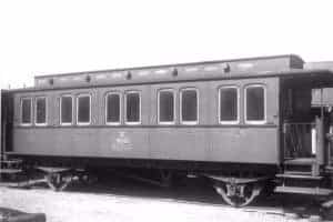

I thought readers would be interested in these photos and notes of the progress of restoration of coach B27 from the Odense, Nørre Broby, and Faaborg railway on the island of Fyn. This coach is a typical restoration from a found body in a summer cabin. The body was donated by the owners in 1987, and of course had no running gear, but the body had been protected by a roof cover and was in excellent condition. Restoration started immediately, but stopped and started with the typical pattern we are all familiar with.
Restoration really made progress under the leadership of our young rolling stock manager, Jesper Kjær Jørgensen, who is a university student at the Technical University of Denmark. Jesper has enthusiasm and commitment, and has lead many projects with drive and determination. The coach is approaching completion and will probably see service in 2019.
The running gear was salvaged from a baggage wagon of approximately the same dimensions.
File comment: Third class compartment finish, as restored.

File comment: In service photo of ONFJ-B27

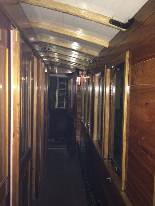

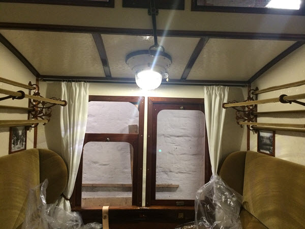

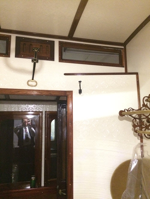

The coach interior has a number of common Danish/Scandinavian features. Note the lever operated ventilation. In the third class, this is a black iron handle. In the second class (this coach has third and second, but no first), this lever is a bronze handle with polished edges. Note the luxury touches in second class, such as velvet on the luggage rack, and the pressed linoleum wall cover (which was custom reproduced for this restoration).
UPDATE: so I am told the velvet on the luggage rack is a creative license because we are delayed in receiving the correct netting that attaches to the rack. It is not the correct configuration.
File comment: Second class compartment towards windows.
File comment: Second class compartment looking towards corridor.
File comment: Corridor of coach B27

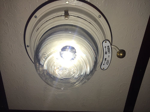

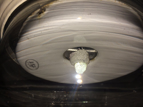

A particular challenge was how to light the coach. The coach was in service to the end with AGA gas light fixtures. Replacement hardware was actually found, but a decision was made that obtaining safety certification and continuing safe operation with volunteer labor was prohibitive, and at risk of future revocation. Some of you may think we are nuts, running wooden coaches with gas lighting. We actually do run some wooden coaches with functional kerosene lamps.
The chosen solution was to electrify with LED bulbs, which also means the power requirements of the coach are easily met with a battery. The LED bulbs are hidden beneath a cosmetic net, that simulates the look of a gas wick. A rheostat was fitted to the old gas regulator, so that passengers may regulate the light intensity.
File comment: LED substitute for gas burner
File comment: Ceiling light fixture on high setting.

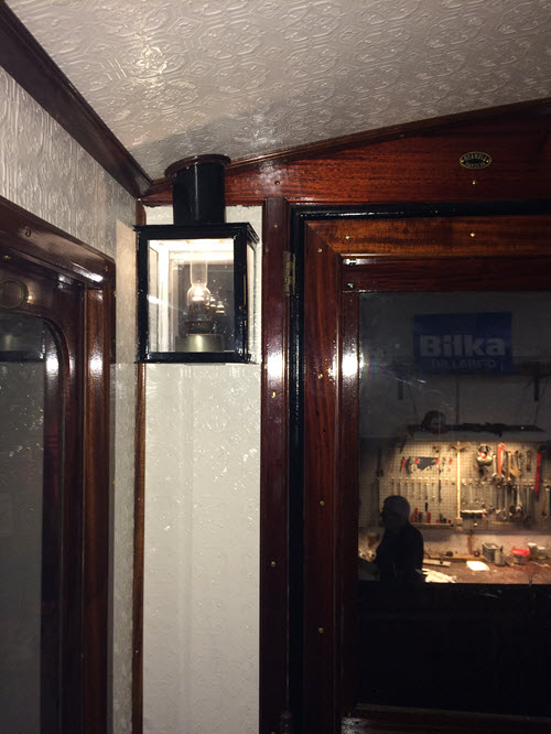

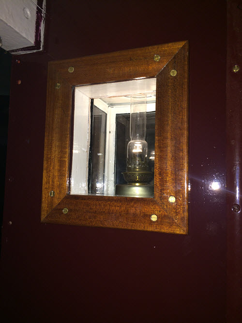

In the platform ends are kerosene lamps that illuminate both inside and outside by their placement at a window on the platform. These have also been fitted with LED.
The coach is steam heated, and we maintain steam heat as our primary heat source. Some coaches are fitted with individual stoves or boilers.
File comment: Platform light through window for inside kerosene lamp.

File comment: Corridor end kerosene lamp, electrified.

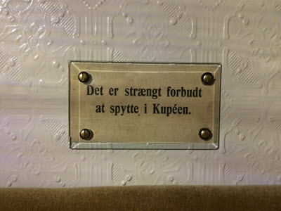

File comment: "It is strongly forbidden to spit in the compartment."
