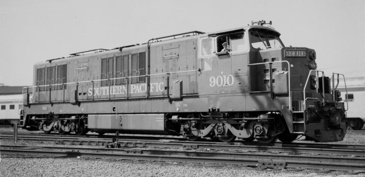

The crew restoring SP 9010 had such a quandary, when the unit was painted in Germany when new, the "kerning" of the road numbers on the side of the cab was incorrect, essentially the numbers were shoved together too tight. I believe they have decided to paint them back in the incorrect original manner, because it is just part of the story of the locomotive (Unknown photographer, from the SP 9010 FB page):

A set of markings being in a slightly odd spot is way more obvious than an extra hole drilled incorrectly in the past.
In the case of the SP KM unit, I agree that the markings should match those in-use as close as possible. But if the folks at KM had put an extra hole somewhere? Nah.
