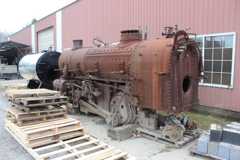

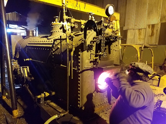

Last week we successfully test fired the boiler on the J&L 58. Actually we did a total of three test firings over two days, looking for and addressing leaks as they were found.
Our next step is to have the Ohio boiler inspector come out to give it his blessing, then we start reassembling the locomotive in preparation for operation in 2019.

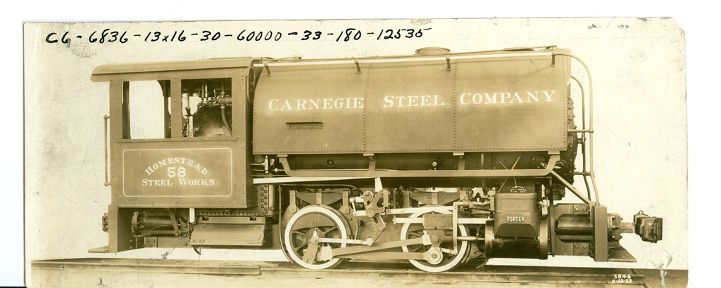

Dave, even Homestead Works had their own 58!

Great to see the progress, waiting to see it move! One question, in the first photo, there appears to be two safety valves just behind the dome, but on the second photo, looks like two globe valves there now instead, tied to a line running off to the right side somewhere....remote safety valve??

train guy: You're being fooled by less than perfect contrast and color rendition. There is at least one safety mounted in the original position. The globe valve you see as what appears to be just to the right of the safety is the steam feed to the injector. From that photo I can't tell if there is a 2nd safety hiding in there or not. If you watch Rick's attached youTube it'll be easier to see. mld

Yeah that is quite an optical illusion. One of the safety valve ports has a new 180 psi Kunkle in place. I plan to reinstall one of the original Consolidated valves in the other port, set to 175 psi. The Kunkle meets the condition for having a Code valve while the Consolidated is built for repeated use without damage.
