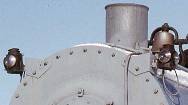

Have another pic of these markers being used. This is on MEC 519. Our markers on 470 are missing the tops. In this photo it appears the tops are conical rather than a domed dish affair. Still hoping someone has some good photos or drawings of these lamps. I am going to attempt replicating replacements.
Thanks
Bob D.

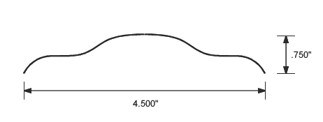

If you have access to the Barrett RR Lighting Encyclopedia, looks like Gray had just the one round cap style from 1911 on, shown fairly well in volume 2, figures 5.32 and 5.33. Profile appears something like this if you don't have access. Dimensions I show are based on the illustrations and actual measurements of Adlake round cap style.

It's been a while since I had one of these in my hands and I don't have time to chase one down right now, (and I didn't check my math that close) but this might make a good starting point if you're in a hurry:
P.Grey 1911 caps.pdf [34.86 KiB]
Downloaded 821 times
A 3-D scan of one would be nice, but short of that or actual PG drawings I think this is close enough for a repro. You're on your own for the embossing though....
G.

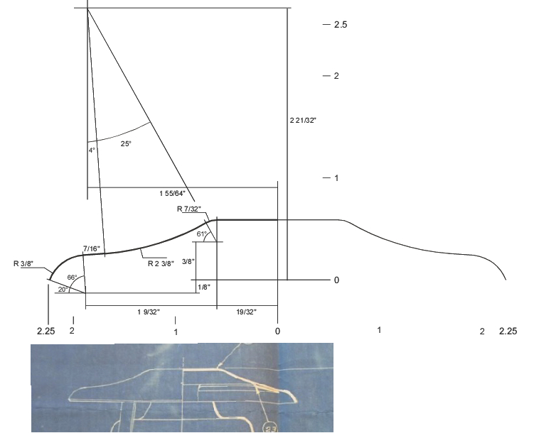

Hopefully you're having some success at finding parts, but in the mean time someone posted a Peter Gray switch lamp drawing on Facebook. The drawing, dated 1922, is here: https://www.facebook.com/photo.php?fbid ... =3&theater.
If you didn't/can't see it, it provides the following information - Gray standard canopy, drawing # is E-510, canopy support is drawing # E-540. The canopy is spot welded to the support, which also appears stamped/pressed, so if you have access to a spot welder it might be easier to repair Gray lamps than finding/making correct rivets for Adlake or Dressel. There is an article from the Cambridge Tribune of 7/7/1923 in the Cambridge Library archives that talks about Gray's adoption of spot welding. There is also an archive reference to an article on switch and marker lamps in the Gray company's magazine, The Graylite, issue 33. There is no mention of drawings or The Graylite issues in the Cambridge Gray archive list.
If you're still looking to make them, I traced the drawing photo (which isn't completely flat, particularly the right side) at 4.5" diameter, then did some more drawing. The result should be much closer to actual than my previous drawing. Although the pic from Bob D. suggested the sharper peak, the found drawing clearly shows a flat top (but it is still embossed). This does raise the possibility that Barrett may have missed a second generation of Gray canopy.
G.

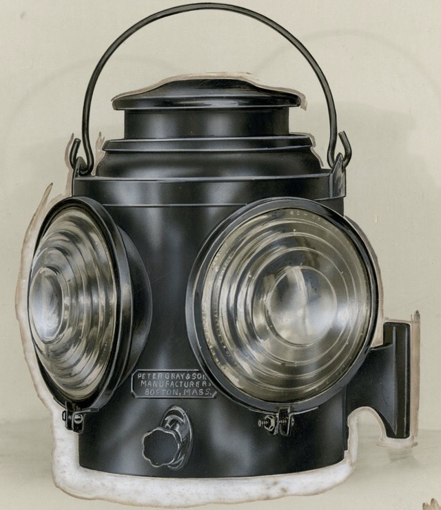

Have acquired a clear depiction of what these markers look like. Of interest is the notation "Peter Gray Turn Top Classification Lantern #1121"
I now wonder if the turn top is how the color selection of the marker was made. There is no evidence in the remains I have of how the internals were set up. The external knob appears to have operated a switch in the lamp socket.
There is no sign of a hinge or welds or holes that held the top to the body. Leads me to wonder if the top had a body that slipped into the main body and could be turned to bring colored windows in front of the bulb.
Thanks for any "light" on this.
Bob D.

If the lamp changed colors by rotating some sort of holder with colored filters, maybe that knob was a spring-loaded pin to lock the selected color in place, rather than being an electrical switch.
It seems odd to me that a classification lamp would have a switch built in to it, rather than relying on a switch in the cab to control all the classification lamps.
Gray used spring loaded pins on some earlier lamps, for example:
U.S. Patent 1062220
 Post subject: Re: Peter Gray & Sons RR Classification lamps
PostPosted: Thu Mar 30, 2017 10:03 am
Posts: 110
Thanks much for the reply Al. The patent info is very interesting. There must be a patent write up for the same classification lamp as we have if it can be found. I have never looked for something like that before.
It is total speculation on my part as to the function of the knob on the outside of the body. One lamp is as pictured but the other is butterfly shaped rather than a knob. They are two position with about 90deg. of rotation. Very low on the body and align with where the lamp socket would have been. There is a small yoke at the end to aid alignment.
I assumed the classification lamps would come on with the headlight. If one had to go to the lamp to set the color they would also go there to shut it off. I think the selection would have been, off, white or green.

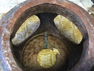

Here is a picture of the interior showing what is on the other end of the knob.
