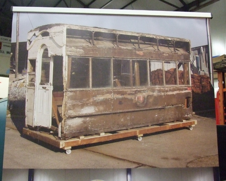

What we started with was this..........

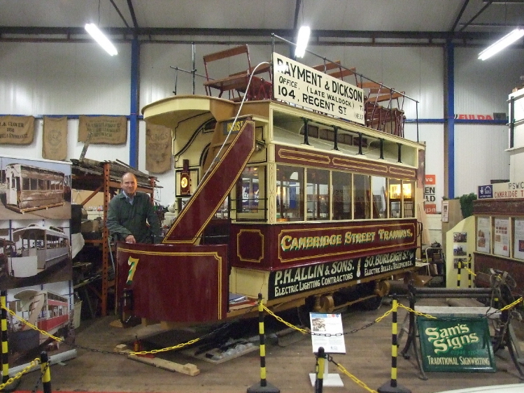

We were able to get a substantial grant from our National Lottery (when such things were easier to get...) of what is currently worth about $65,000 US and a small but dedicated team of 4-5 regular volunteer workers have now transformed it into this.....
The chap standing by the car is Tony White, our (volunteer) master woodworker, who has been responsible for all (quite a bit!) of the new woodwork - though there is a substantial amount of the original material reused in the job, despite the apparent state of the remains in the first photo. The original bodyside panelling, which was carefully rubbed doen to reveal the original lettering and advertisements have acually been removed and conserved and provide a seperate display next to the tramcar.

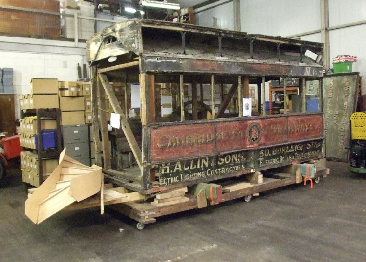

The side which can be seen in the "before" picture posted above was tackled first, and this produced the Cambridge maroon livery & lining out, plus some advertisements...

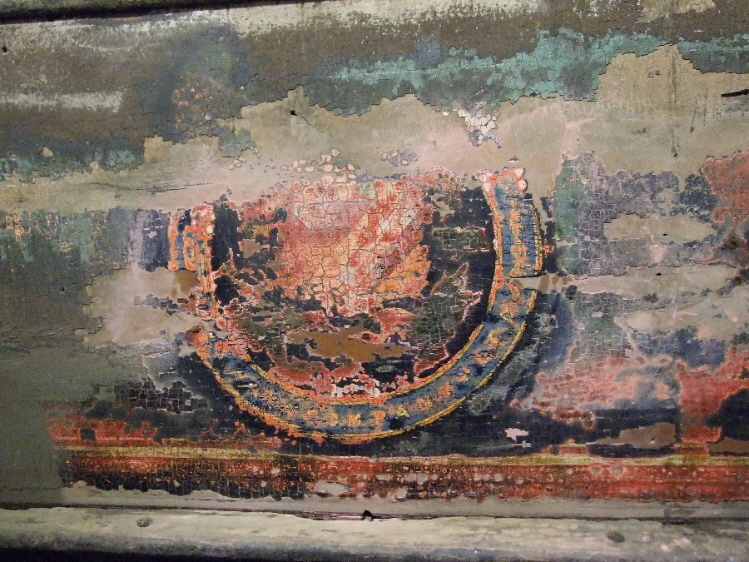

It also revealed the Cambridge fleet #7 (just discernable) in a circular device that didn't make much sense at the time...

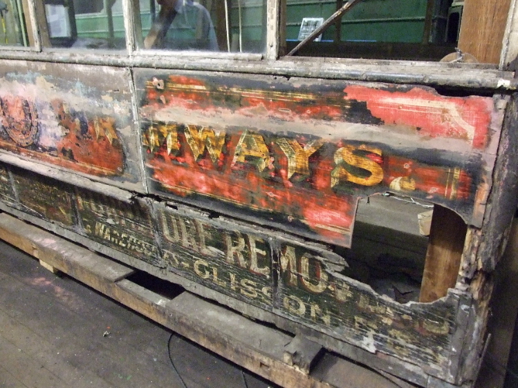

Things got more interesting on the other bodyside, as rubbing down of the circular device revealed the crest of Bradford City and wording along the lines of "Bradford and Shelf Tramways Company". On top of this, reference to Bath Tramways was found on some parts removed from inside the passenger saloon, and these dated from when the car was built back in 1880 !!
This side of the car is shown below, as of January 2013, when the results of the Lottery application were still awaited. The Bradford crest can clearly be seen in the centre of the side panel.

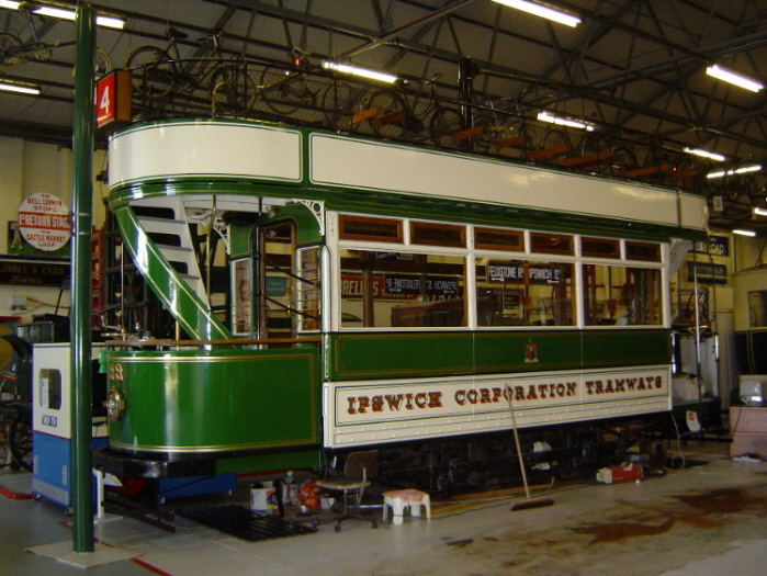

The group of volunteers who have been working on the horse car were also responsible for restoring our 1904 Ipswich double-deck electric car, which also started off as just a downstairs body (plus the end platform supports) after being used as a storage shed in a domestic garden between 1926 and 1976.
The truck is a Brill 21E one that we obtained from Lisbon in Portugal a number of years back. The idea was to convert it to 3'6" gauge, but it has been left as Lisbon gauge (900mm, from memory), given that it wasn't restored to operating condition and we haven't got anywhere to run it
