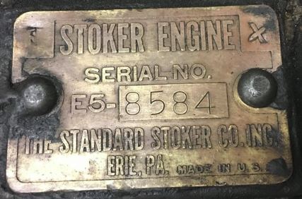

Does anyone have the technical manual for maintaining this steam stoker motor? One of our mechanics is tearing down the unit and cleaning up the damage caused by exposure to weather. Please contact us off-board, either by PMing me or emailing newenglandsteamcorp@gmail.com .
All assistance is appreciated. We've had a spectacular 2018. Here comes 2019!
File comment: Maine Central 470 stoker motor.

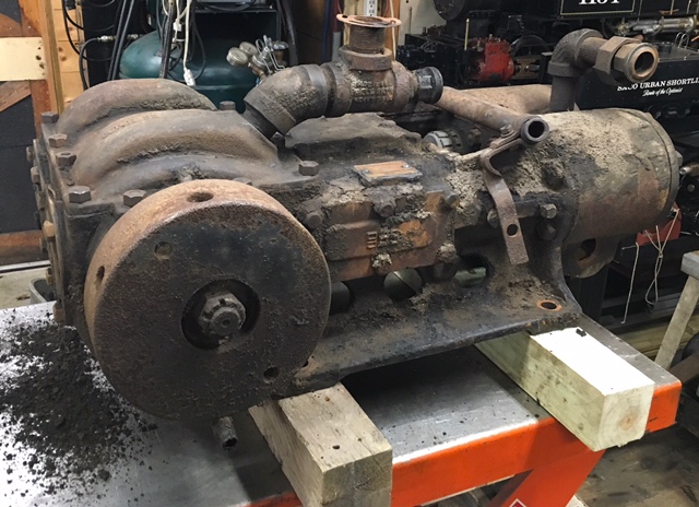

This is a Standard Stoker Company HT-1 stoker system with a two cylinder 5"x5" steam engine driving it. The goal is to first make the engine operarational. I have the catalog descriptions and parts list with drawings. What I really need is servicing/rebuilding literature. Must be a shop manual out there somewhere....
Bearing clearance specs, fastener torque specs, bore to piston fits, valve fits etc.
The crank is running on roller bearings and with the short stroke I imagine this is considered a "high" speed engine.....anyone know the rated rpm is? or hp?
Valve gear is fixed with an external steam valve as throttle and reversing the steam direction to reverse.
Any guidance on the engine or the stoker system is appreciated.
Bob D.

I guess that my biggest concern was the piston to bore fit limits. I have info on the 5"x5" with .005"-.008" clearance to a max of .020" with standard rings. Catalog parts listings show rings 1/32" oversize for standard pistons so that would be .03125" + (.020" limit?) clearance.
The pitting of the bores I believe will clean up within .020" -.030" so I should be ok with oversized rings fitted to standard pistons. I'd rather not make oversized pistons...
When I mentioned ball bearings that is just on the crankshaft mains.
Has anyone measured these or know a modern bearing number replacement? That and the two crank seals? They look felt but I would think a modern lipped seal would work ok.
Probably neither the bearings or seals have to be replaced but just curious what options are out there.
I get the rod cap fits and adjustments. Cap nuts need to be tight and then brought to the nearest hole for the castellated nuts. There was quite a difference between the fastener tightness between the two piston rod caps.
Does anyone know if the piston and valve packing assemblies need to be removed before the cylinders are unbolted and removed? I don't see a lock screw for the packing base like on the 7"x7" engine. I believe the threads are in the block and not the cylinder casting.
Haven't parted the piston rod taper to crossheads yet. Was thinking of making up a jacking screw whose nut is a slug that replaces the wrist-pin. Load it up and whack it. Maybe a little heat on the crosshead first to warm it up. Not really sure what it will take to seperate these.
Just starting this project, in the disassembly/inspection cleanup aspect.
If there is interest I can post some pics of progression.
Just got to remind myself it's not a performance infernal combustion engine........
Does anyone know where the crankcase oil level was to be maintained? To the plugs partway up the block side? One of them has a small petcock. What oil for the crankcase?
