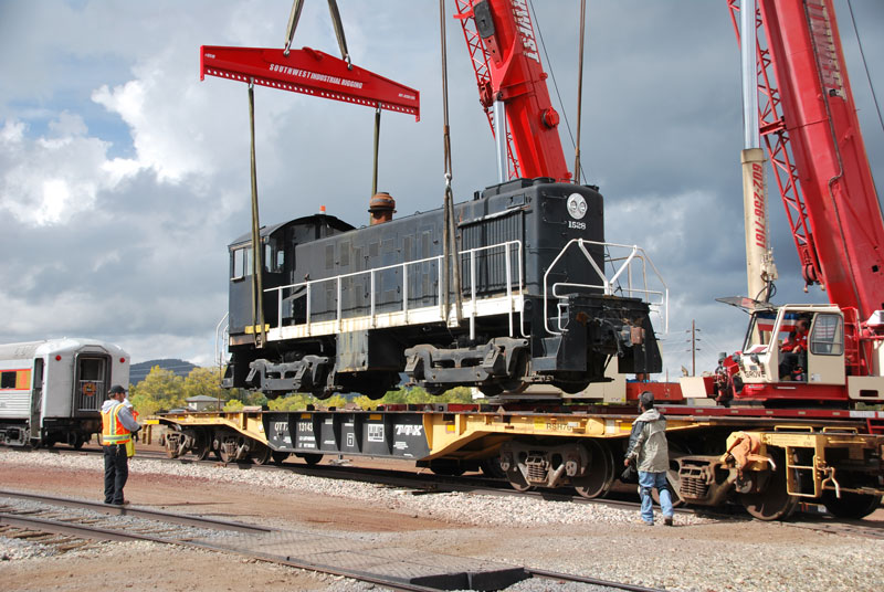

The fledgling Arizona State Railroad Museum, still working on finalizing zoning approval for its proposed museum site here, has added yet another significant Arizona locomotive to its rolling stock collection: former Atchison, Topeka & Santa Fe Alco S4 No. 1528. The locomotive arrived Oct. 19 and was scheduled to be offloaded Oct. 23.
The locomotive was built in July 1952 and was one of 38 Alco S4 models on the Santa Fe that were built in five different orders between 1951 and 1953. According to museum officials, the 1528 spent its entire Santa Fe career working in Santa Fe's yards in Phoenix. Retired in December 1974, it was sold to Birmingham Rail & Locomotive of Alabama in April 1975, which resold it to Continental Grain for use at a large feed mill in Gilman, Ill., later taken over by Cargill. The loco was replaced at Gilman in July 2015 by an Alco S2 rebuilt by Chattahoochee Locomotive. Arizona State Railroad Museum purchased the former 1528 in April 2017.
The loco was originally painted in Santa Fe's drab black with silver safety stripes/highlights, and was repainted into the later ATSF blue and yellow scheme at some point in the 1960s. Continental Grain had repainted it into a U.S. Bicentennial paint scheme for the 1976 celebration, but repainted it into drab black after an engine fire around 1978. Bachman produces an N scale model of this locomotive in its original black scheme.
The museum's rolling stock collection, stored on a siding near the shops of the Grand Canyon Railway and at other locations, includes Southern Pacific NW2 No. 1317, built 1941; Black Mesa & Lake Powell E60C electric locomotive No. 6001; a Shay locomotive; a Phoenix Valley Metro light rail prototype car; a narrow-gauge Porter fireless 0-4-0; and several freight cars.
Photo by Al Richmond, courtesy ASRM

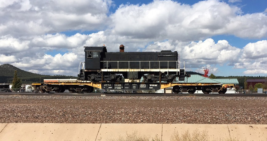

Unloaded today. Note the cast Santa Fe numberplate still intact. Sadly, the horn and bell were stolen, most likely at the Galesburg, Ill. yard.
Cargill officials reported that the loco was apparently last started up within the past six months--or, as they say in "barn find" car ads, "ran whemn last parked!" Although the supply of 539 parts is problematic, ASRM officials may consider an operating restoration in partnership with the Grand Canyon Railway (which uses a Sky Trak "telehandler" as a "shop switcher").

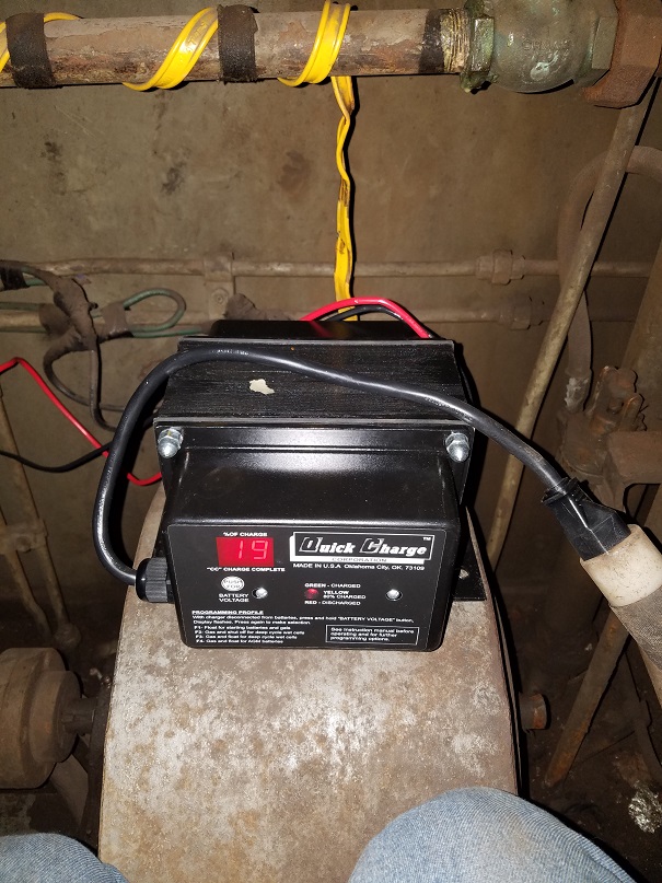

To maintain the batteries I have an onboard 72 volt battery charger that is mounted in the electrical cabinet. Runs on 120 VAC. It keeps the batteries charged although I have found that it should not be left on all the time. Just enough to keep the batteries charged.
