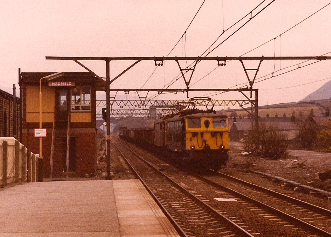

My understanding is that for lower voltage DC systems, more than one pantograph was used due to the higher draw of traction current from the overhead wires.
The former 1500V DC line here in the UK between Manchester and Sheffield via Woodhead tunnel required both pantographs to be raised on locomotives, even when working in multiple.....(4 pantographs raised here)

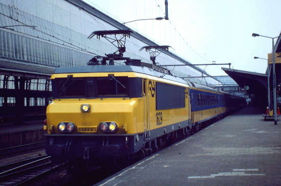

Dutch Railways (also 1500V DC) also used both pantographs when starting trains away from stations........

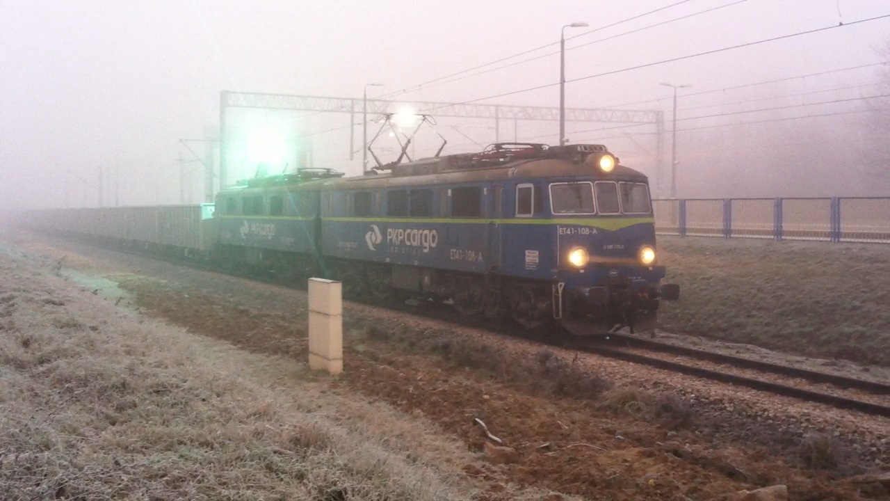

One day last month in Warsaw everything was covered in a thick layer of frost. Proved to be quite an interesting sight.
