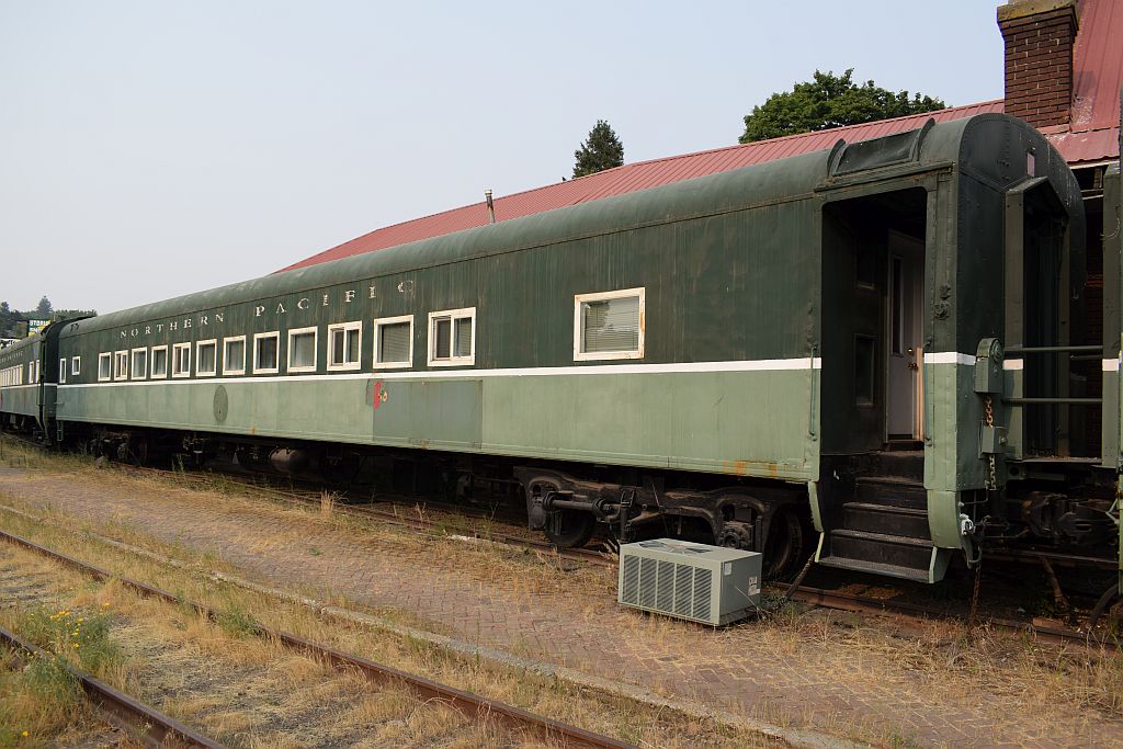

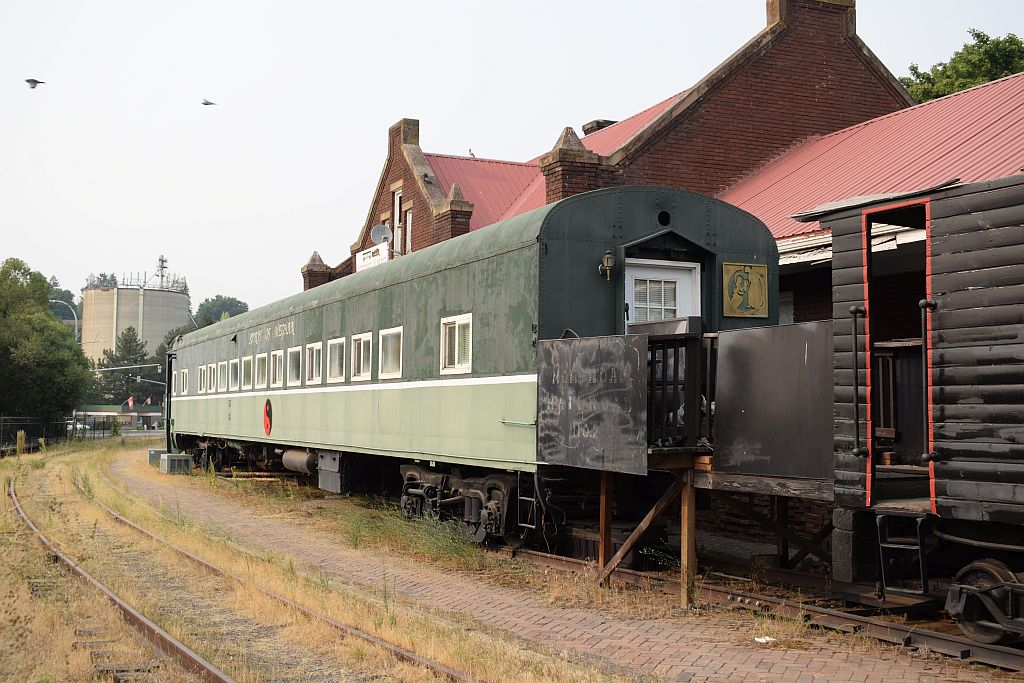

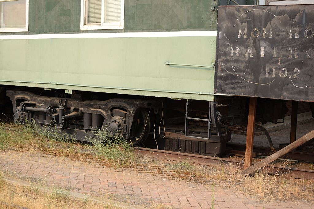

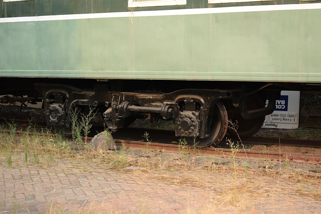

Hi there. I am involved with a group in Pullman Washington that recently took ownership of the former NP/BN depot there. This depot had been privately owned, and the former owner had placed a few coaches on display on what was the platform. Now that plans are taking shape to restore the depot we are wanting to get rid of two of these coaches to expose the building, currently all that can be seen is the coaches and the roof.
We are uncertain of the exact history of the cars, but both are beveled to be Pullman Standard coaches built for Great Northern. They last saw service for Metro North. Both were gutted and converted to living and restaurant space, though both are empty currently.
Originally it was thought that due to poor condition it was thought that the cars would have to be scrapped. However a potential new home with a private individual has opened up.
This person wants to truck the cars out to their property. Of course the first question he is asked is what is the weight of the cars? In talks with him it is believed that the best method to move the cars would be to lift them off their trucks and move the cars bodies and trucks separately. So I'm wondering if anybody has any idea of how much the cars and trucks would weigh. Pictures below.
File comment: Trucks missing pieces, one pair
File comment: Intact trucks, one pair
File comment: Pullman standard steel coach #2
File comment: Pullman standard steel coach.

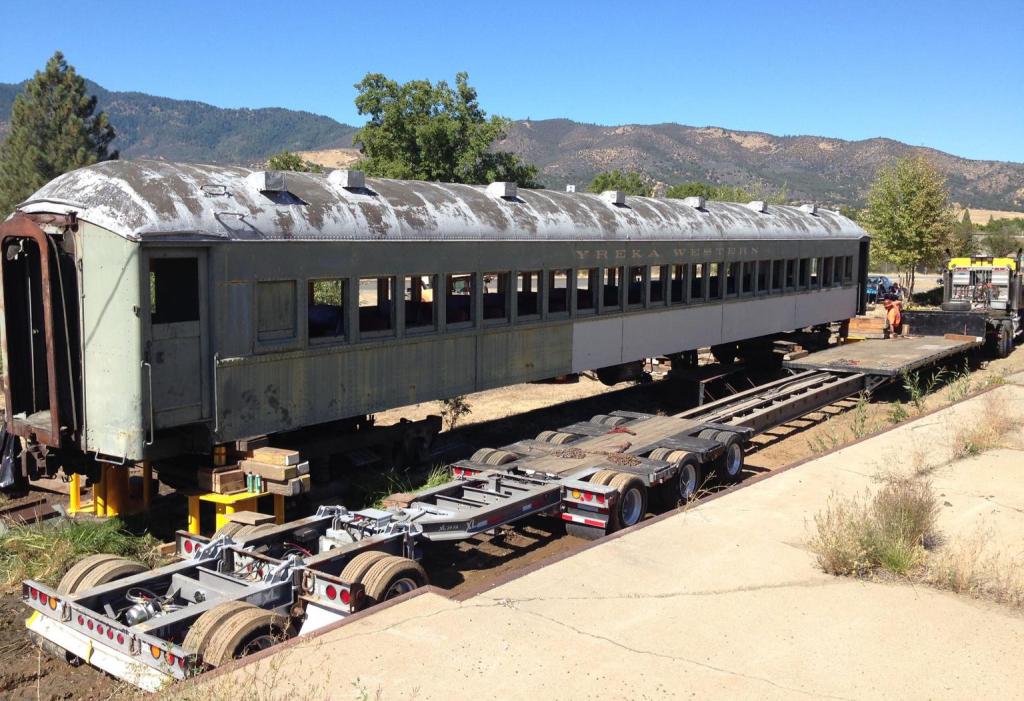

I don't know if the potential buyer already has a line on a mover, but about 11 months ago NessCampbell Crane & Rigging out of Portland, OR moved a couple of SP coaches from Yreka, CA to Tillamook, OR on behalf of the Oregon Coast Scenic, using the method you've described. Photo below is of the flatbed they used.

One of the cars pictured has disc brakes, which would explain the "missing" brake cylinder on that particular car.
Looks like a lot of parts have gone missing from the trucks on both cars.

Both cars have no brake gear whatsoever. I agree, one of the cars would have originally had disk brakes however it has nothing now. As the story goes rather than pay the crane company anything the original owner allowed them to salvage anything of value from the cars. As they sit now they have no brake gear, wheels are minimum legal thickness, and many of the bearings are taken apart or simply not there... I believe that at least one wheel set is actually a friction bearing axle sitting in an empty roller bearing box! No brass or wedges either.
