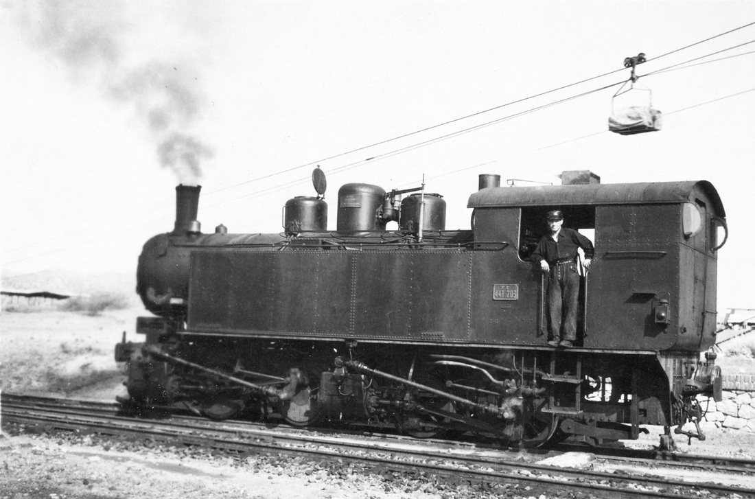

I found this photo of an engine used in Eritrea with what looks like (to a novice) a similar valve system, but missing the large tank on top of the boiler and with a different style cab- perhaps modified later in use. What is the thing that looks like a stack just ahead of the cab in both photos BTW, a water fill perhaps?
 Post subject: Re: Italian Articulated with Caprotti Valve Gear
PostPosted: Mon Aug 27, 2018 2:19 am
Vacuum brake ejector.
And the number plate does show class 441 clearly.

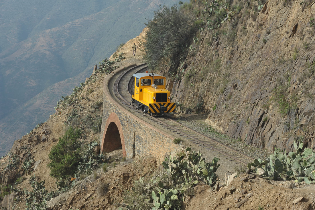

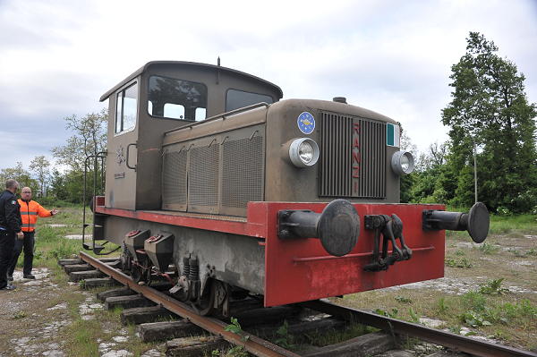

Stefano Pettini, an Eritrean Railway fan who set up the page I posted earlier (http://www.ferroviaeritrea.it/), has managed to see through a project to donate seven small diesel switchers, on the order of a GE endcab switcher, plus four of something called a loco tractor that looks like a jeep with hi-rail wheels as best I can tell, from the Italian Air Force to the Eritrean Railway. As he says on the website (in Italian and run through a translation program by me):
"The project "Italian Locomotives in Eritrea" was born at the beginning of 2011 as a personal contribution to the efforts of the Eritrean authorities to keep alive an infrastructural work of art with few equals in the world. The fleet of machines that has been painstakingly recovered from oblivion in which he had lain for dozens of years suffered from serious functional deficiencies due to the impossibility of finding spare parts to carry out the necessary periodic maintenance, but above all the lack of reliable small machines suitable for tow short trains to carry out maintenance work along the railway line and maneuvering inside the stations...As a lover of things railway I knew that the Italian Air Force, in which I have served throughout my career, had spread in several locations of the diesel maneuvering machines that made short services for moving rolling goods in military areas, and that as a result of changes in the transport strategy these machines were no longer in use. What better opportunity to acquire material that due to its characteristics suited very well to the needs of the Eritrean railway. No electronic technology, very robust but simple structure in the assembly and above all suitable for the conversion of the gauge from normal to reduced Italian (95 cm)...In detail, the motorized vehicles destined for Eritrea are: one Greco, two Ranzi, three Badoni VC, one Badoni NLR and four road- Zephir rail."
He says he expected the donation to be simple, as the units were no longer needed, but it became a bureaucratic morass involving issues of shipping military goods overseas, etc., Nonetheless, by earlier this year the units were re-gauged, had their two buffers replaced with a single centered one, painted, etc. and were shipped to Eritirea: https://www.youtube.com/watch?v=3Aq0XSM72jA
Super cool.
