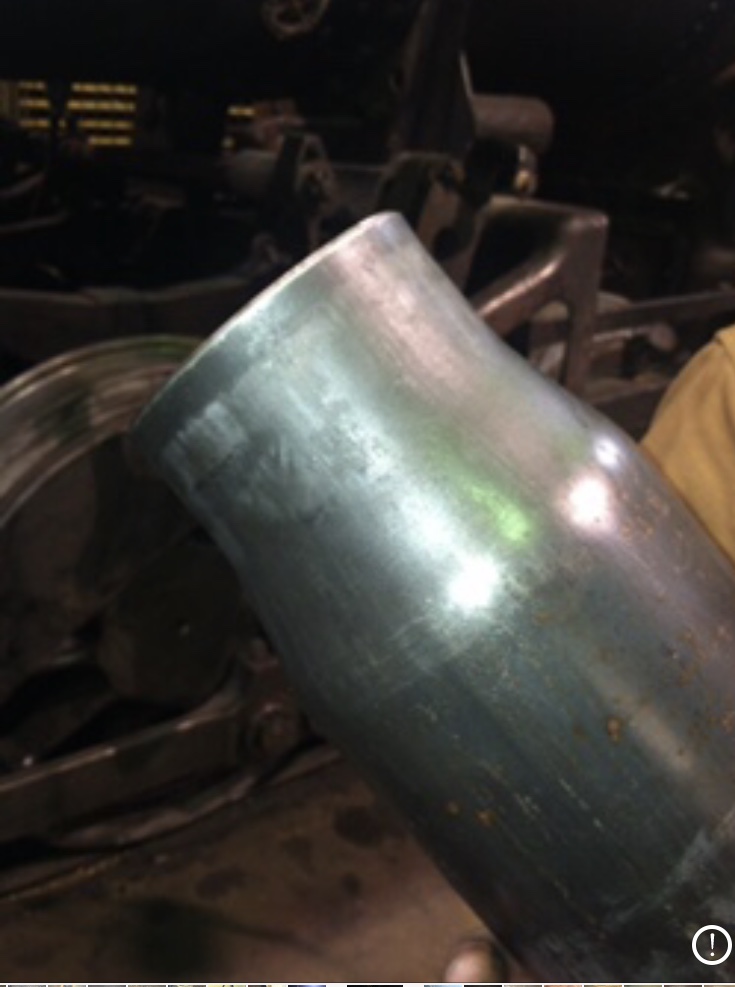

Make a die and press the material through. Here is a 5.5 sample we did in about 2012
Best,
Stathi
