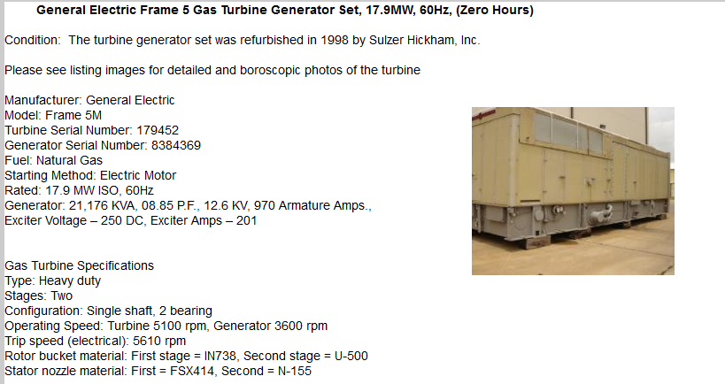

File comment: I found this on the Web
Hi Big Boy 4023
I found something dealing with the Gas turbines, I put a search in for GE 5 gas turbines I am not sure if this is the answer you are looking for? please see attached.

Pat, The GE frame 5 fitted to the UP locos was of special design for their purpose as railway prime movers. The generator types were different as the turbine you linked is setup for power grid voltages instead of the typical 600 volt DC traction motor voltages.
It's been rumored that salvaged turbines from the big blows ended up on river dredges and in the oil and gas fields.
