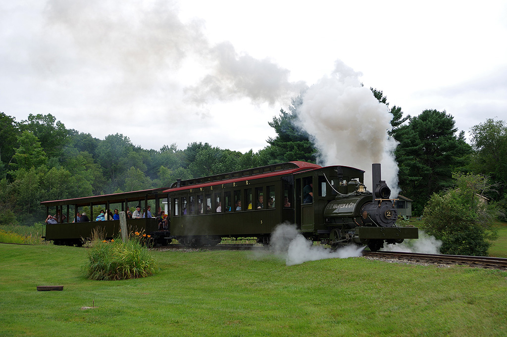

Here's another view of her in action Saturday evening, pulling the first of three passenger trips (two laps each) around the Boothbay Railway Village loop. She looks lovely in Baldwin green, and for such a little engine she has a very satisfying bark climbing the grades there.
File comment: S.D. Warren no. 2 with her first load of passengers Saturday evening

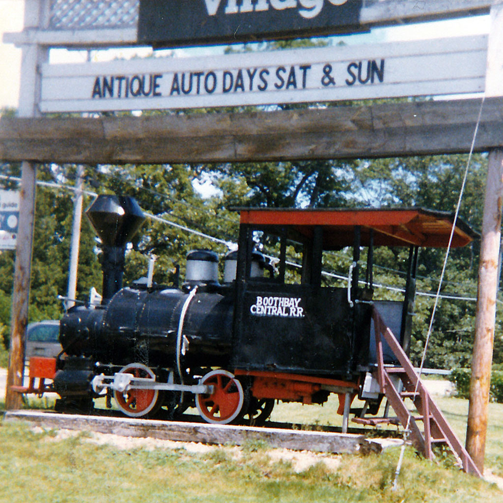

Also, for a comparison, here's she is the first time I saw her, doing billboard duty back in 1984.
File comment: S.D. Warren no. 2 under the sign at the entrance to Boothbay Railway Village, July 1984

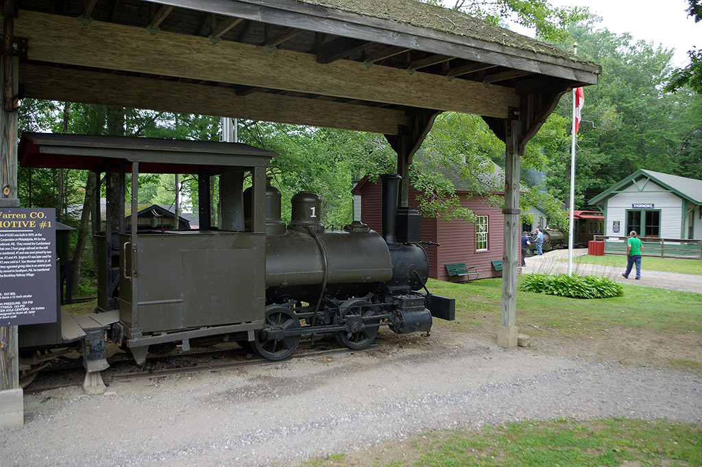

With the return to service of no. 2, sister engine no. 1 now has the distinction of being the only remaining historic Maine two foot gauge steam locomotive that has not steamed in preservation.
File comment: S.D. Warren no. 1 on display, with no. 2 steaming in the background.

So how were these engines motorized? Gear on the rear driver with a small motor in the firebox?

Yes, the firebox was cut away inside the cab and a gasoline motor was installed, with a chain drive to the rear axle. No. 1 has a four-cylinder Ford motor in her, which I recall was exposed when I was there in 1984. It's now covered under a plywood box, but I believe it is still there. The gear and drive chain is visible under the cab. No. 2 had a different engine (but I don't recall what), with the original Johnson bar being used as the shifter! They were converted by the previous owner, a theme park in New Jersey, soon after they were acquired from S.D. Warren. I heard the theme park tried running them on compressed air for a short time before they were motorized.
