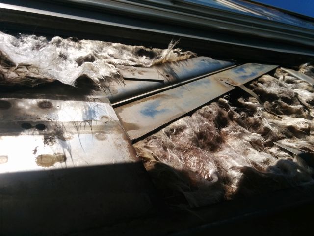

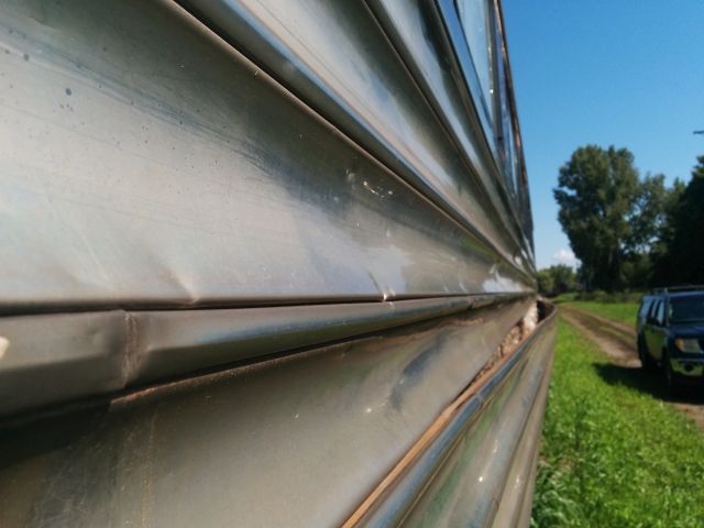

Couple photos to share. The top one shows what's underneath the buckle (looking up from the bottom), the bottom shows shows the fluting coming off. Any ideas on the best way to fix this?
