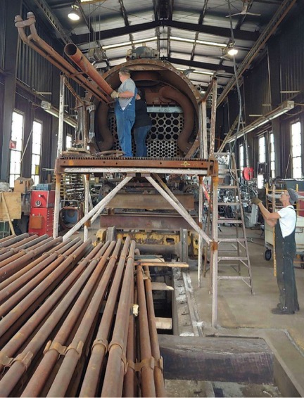

#1309 Rolls Forward As Super Heaters And Appliance Installation Gains Momentum
Ridgeley, West Virginia, June 22, 2018:
Western Maryland Scenic Railroad and Diversified Rail Services are very proud to announce additional progress in the ongoing overhaul of Western Maryland 2-6-6-2 #1309. Since the successful hydro has been completed an impressive checklist of appliances and parts have been reinstalled.
• The top row of Type-A super heaters has been installed. There are a total of 36.
• The cab floor, stoker elevator tube and grate shaker levers are installed.
• The grate structure and ash pan are attached.
• Steam and water pipes for the injectors are being fit up.
• Steam lines for the blower and air pumps have been attached.
• Grinding and cleaning up washout seats
