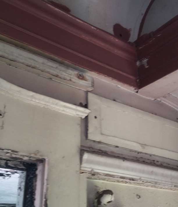

Back to the topic of steelwork done to resemble woodwork, here's a fair bunch of it in this photo. Note the panel above the door to the left, which has the arched shape the photo barely suggests.
