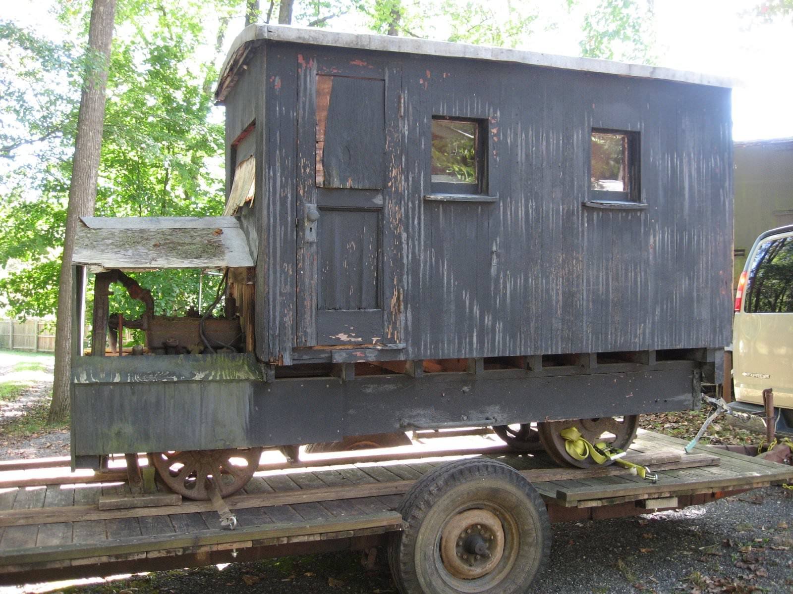

A friend of ours recently picked up this rail truck off ebay. It was in Maryland, south and east of DC. Its now in NJ and a couple of us working on the Hainesport PRR cabin car will be helping out the new owner. Looks to have a Model A engine and transmission, although that is to be verified. Looks like a Model A or T rear axle which was nicely narrowed for use on rail. The kicker is that it looks to have been built to 27” gauge. I have seen some odd narrow gauges, 48” and 40-1/2” being a couple. The 23” that Rick Rowlands was working with I see as odd. But, 27” gauge is a first for me.
Not sure which way the new owner will go with it gauge wise. Its actually fairly solid, a steel forward frame, wood rear frame, the tin roof on the body really saved it all from the elements.
Apparently home made, but the axle work is very well done. I really wonder where the parts came from originally. It really has the back woods look.
I’d be interested in anyone who may have heard of any 27” gauge operations.
J.R. May

Interesting, the front wheel looks like a standard motorcar wheel, but I've never seen anything like the rear wheels, they look custom to me. Hopefully someone can give you insight as to where the car used to be operated as any railroad with a piece of equipment like that has to be an interesting one!

There is lettering cast into the rear wheels, but in the rain yesterday I was not curious enough to get soaked trying to see it clearly. Hopefully this coming weekend we will be able to take a closer look at it. That assumes the rain ever stops.

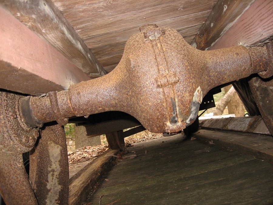

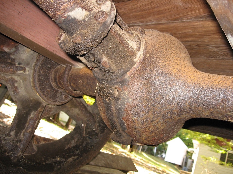

Here's a few photos of the rear axle.
Thanks for the help,
J.R.

JR, 1920-27 Model T rear axle housings (passenger car). It would be interesting to see how they adapted the model A transmission to the T driveshaft housing. It could be the bells are the same size, I don't know!
Steamcerely,
David Dewey

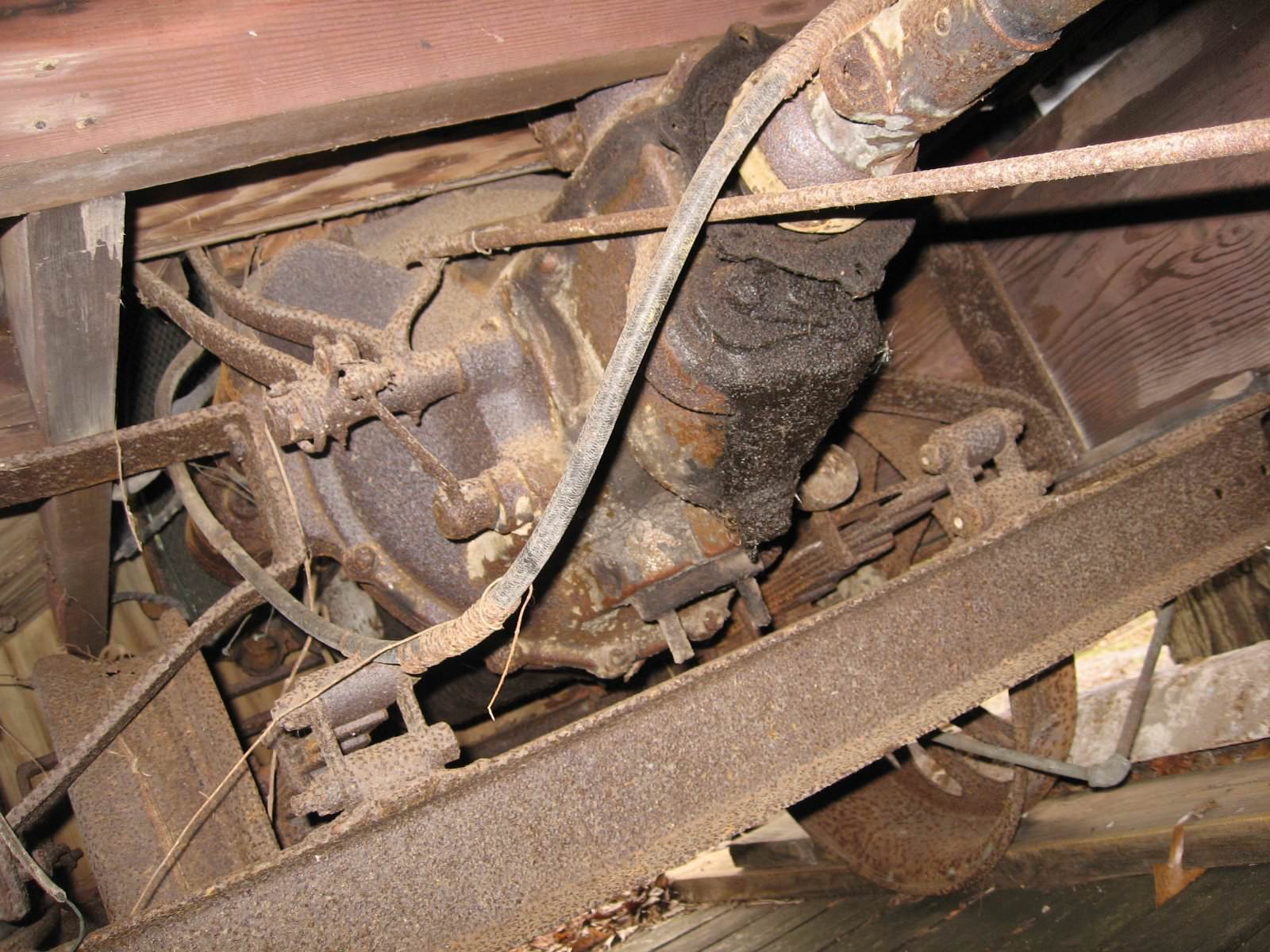

Transmission photo is attached. Appreciate your tech data. This is very useful.
J.R.

Interesting that the front axel is sprung, and the back one solid. I wonder if the front end may have been assembled for something else and later used on this one.
Mike.
