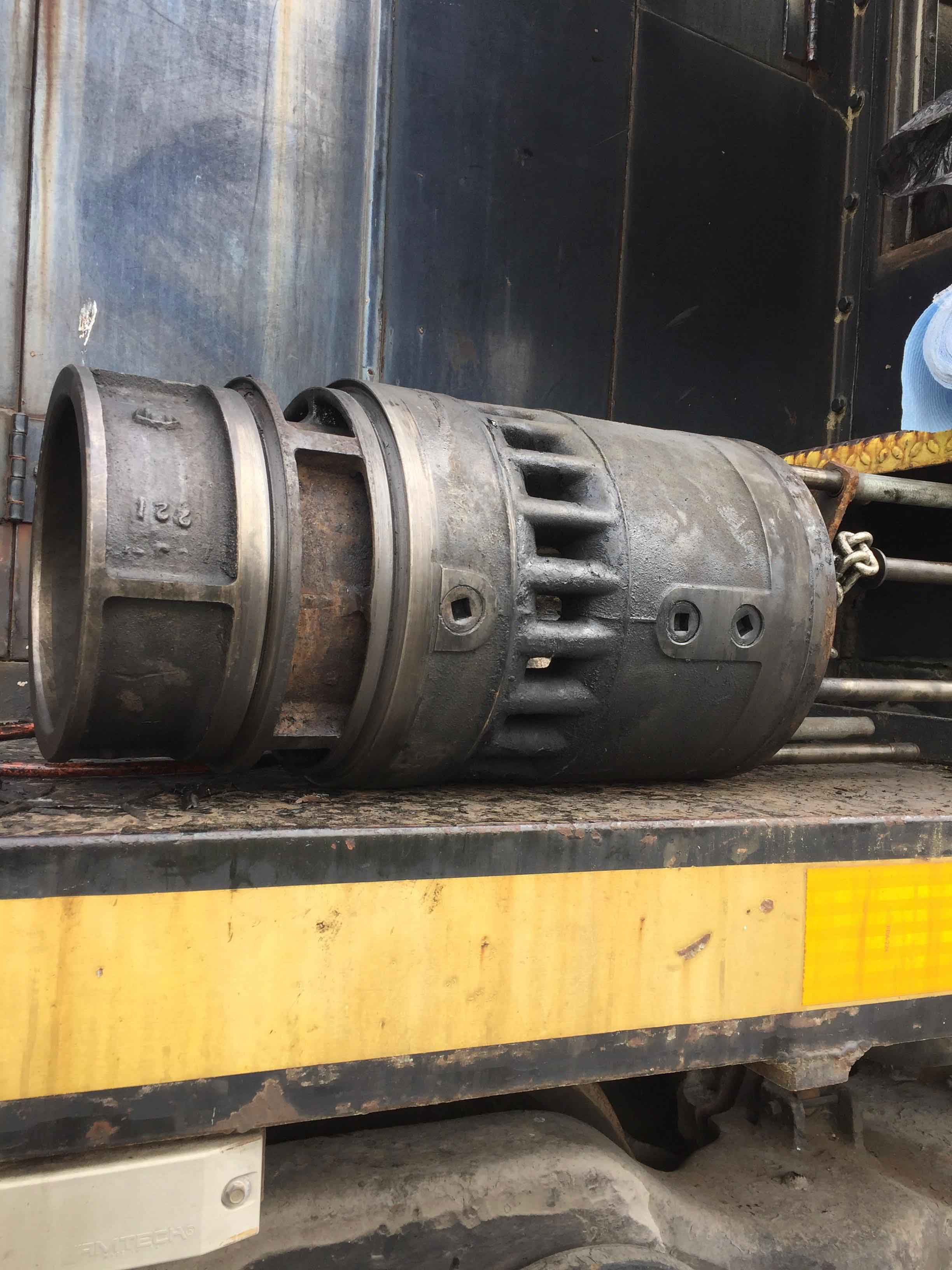

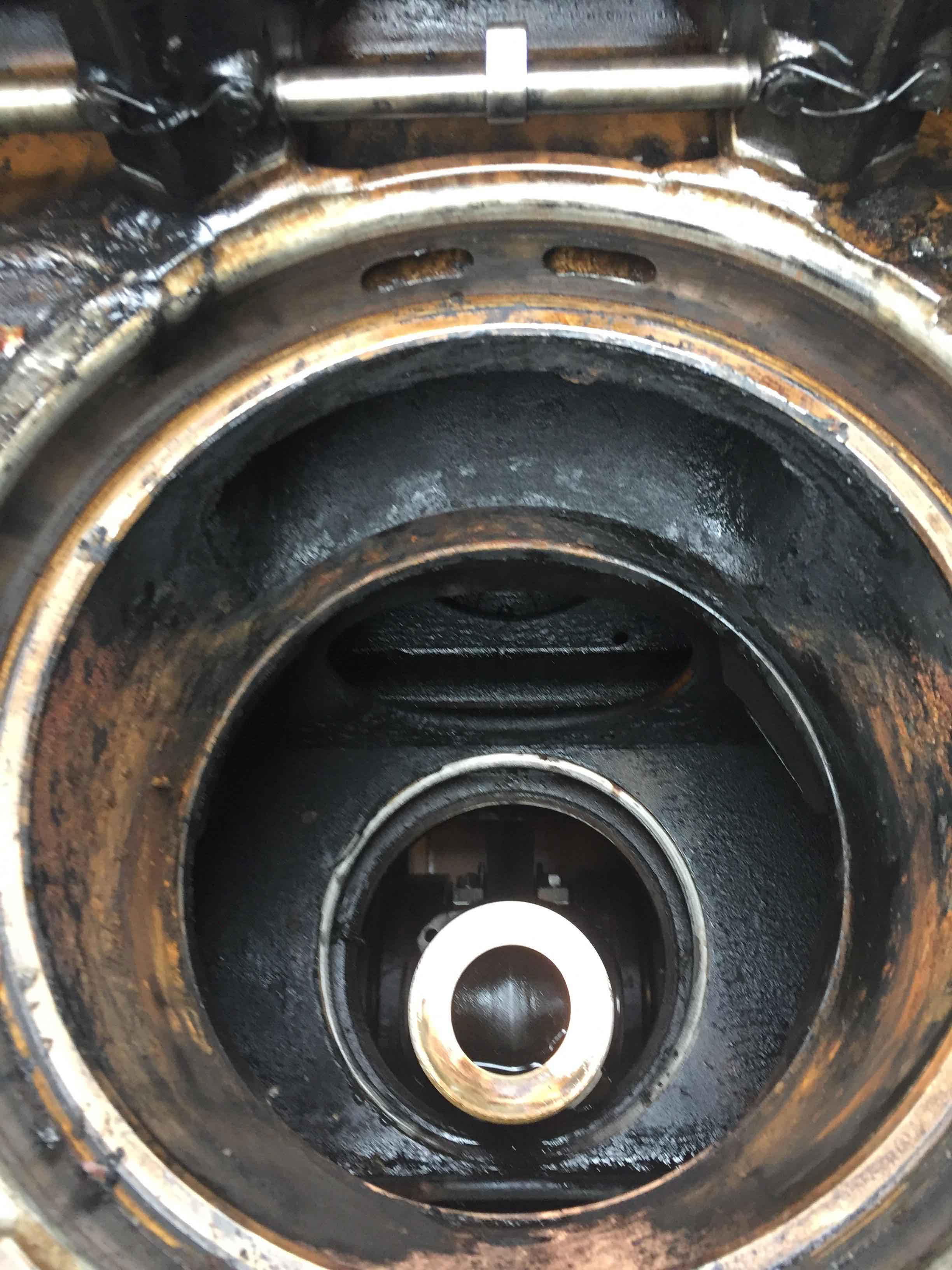

We started on our project. Attached are a photo of the first power assembly cleaned up and an inside shot of where it came from.
