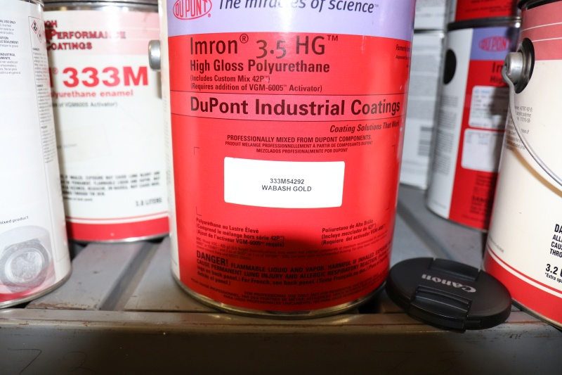

 Post subject: Re: B&O Color Info
PostPosted: Mon Apr 30, 2018 6:52 pm
Joined: Wed Mar 01, 2006 4:29 pm
Posts: 84
Location: Monticello, IL
File comment: DuPont Imron version of 54292
Something like this? That particular color of "imitation gold" was used across several carriers at the time. We worked with the late George Rust of DuPont to get this color matched into current (at the time) formulations. It was also used by the Wabash for their lettering on cars and diesel locos. Our supplier is Kelly Industrial Coatings of Waukesha, Wisconsin. I expect at this point, we would have to supply them with our drift card of this color for them to reformulate into the current standard Axalta product.
PostPosted: Mon Apr 30, 2018 7:49 pm
Posts: 2075
Kent,
Thanks for the info. Though the Dulux Bando Blue code above turns out to be the same as the Wabash Blue code on my list, something I didn't realize, the B&O imitation gold numbers don't compare or cross with anything else I have. That might explain my difficulty in pinning it down. I'll add it to my list, though. Roughly what year was this mixed?
PostPosted: Wed May 02, 2018 8:53 am
Posts: 2075
Kent,
I must need a new pair of glasses. Duh. Your Imron number for the imitation gold is a match to what I'm looking for. Now to see if I can get some kind of cross to Axalta, PPG, etc.
