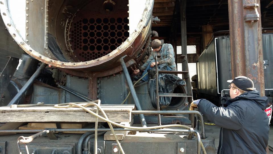

As posted on the Midwest Railway Preservation Society's Facebook page, work is resuming on the restoration of GTW 4070, a 1918 USRA light mikado located at the Clark Aenue roundhouse in Cleveland, OH.
"Well after a long period of time we finally have some funds to continue work on the 4070. So we now have a group of volunteers to do work on her. The first project is to remove the smoke box and the taper bolts as they all need to be replaced and the smoke box repair. Then the front tube sheet will be removed in the coming weeks."
