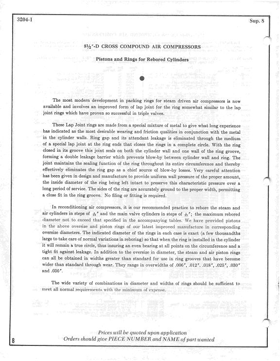

Our group is current rebuilding an 8.5" Westinghouse CC air compressor. Can anybody point me to information on the oversize steps for the cylinders? Happily they appear to be in serviceable shape, but it would be nice to know where this compressor has or has not had in cylinders bored out in the past. Years ago our group worked on an 11" compressor and at the time this kind of information was available on-line somewhere (Bernie Watts?) but I can't find anything now.

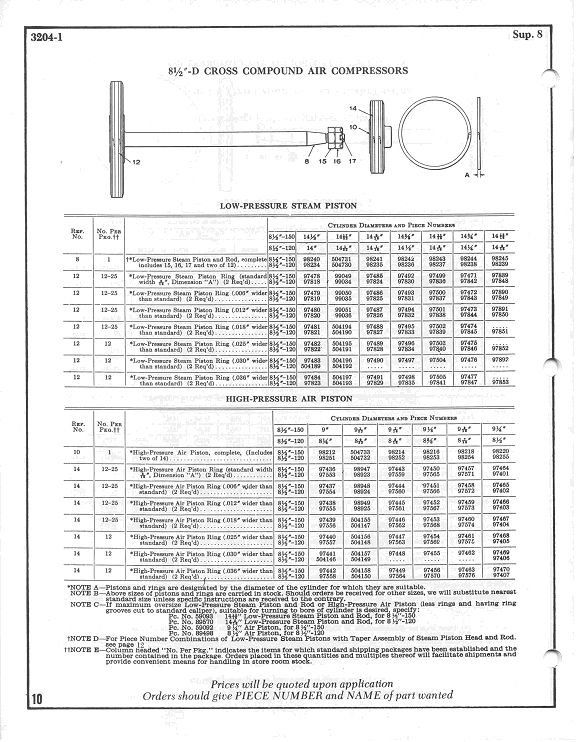

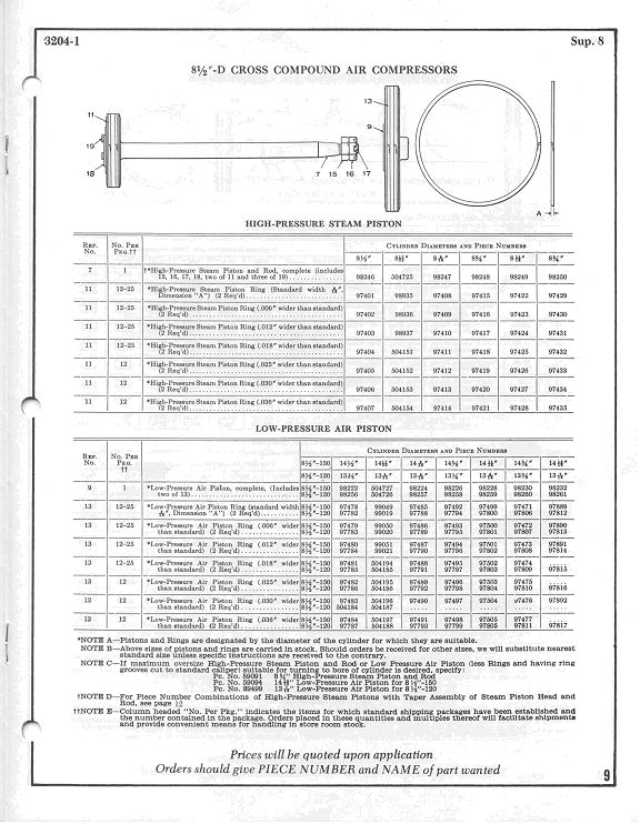

Here are the pages from the WABCO repair parts book. They recommend boring cylinders in 1/16" steps. To my knowledge, Bernie is still using the same part numbers.

Russ,
Thank you very much for this. It's exactly what I remember and what I was looking for.
The only catch is that the resolution is a bit low, and it would be nice to also have the corresponding information for the main valve cylinder. This is an "old style" compressor with a slide control valve.
