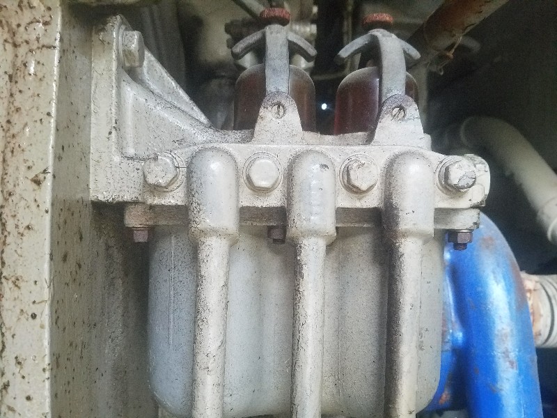

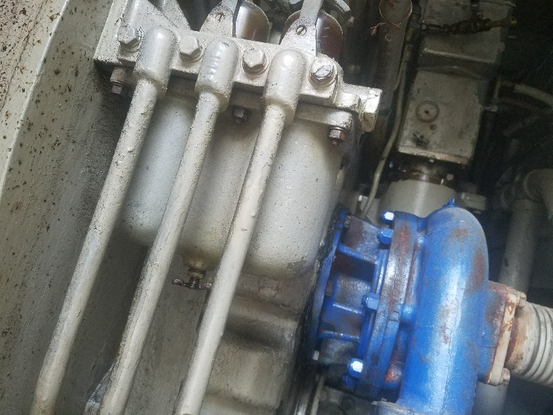

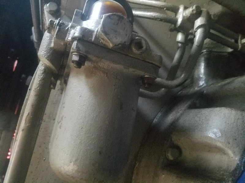

I will call this week and order parts, I just thought posting pictures of the current setup and then adding pictures of the conversation later.

One thing to keep in mind is the old style filter upper has the relief valve behind the large hex. These are prone to sticking and the result is typically a shattered secondary sight glass with the resultant fuel spill. Best to remove the shuttle and use modern 10 and 60 pound relief valves. The engine will continue to run with a shattered secondary sight glass until the tank is empty.
