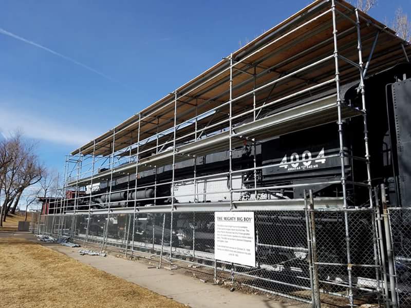

The cover is almost complete, and asbestos abatement will begin end of next week......amazing to get up this close.

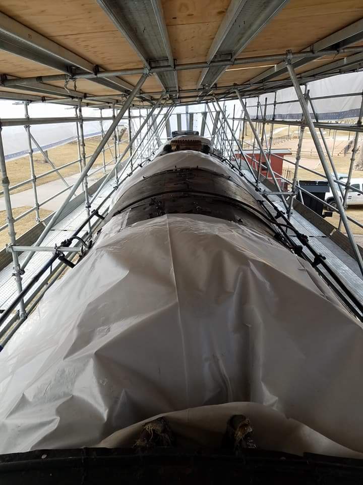

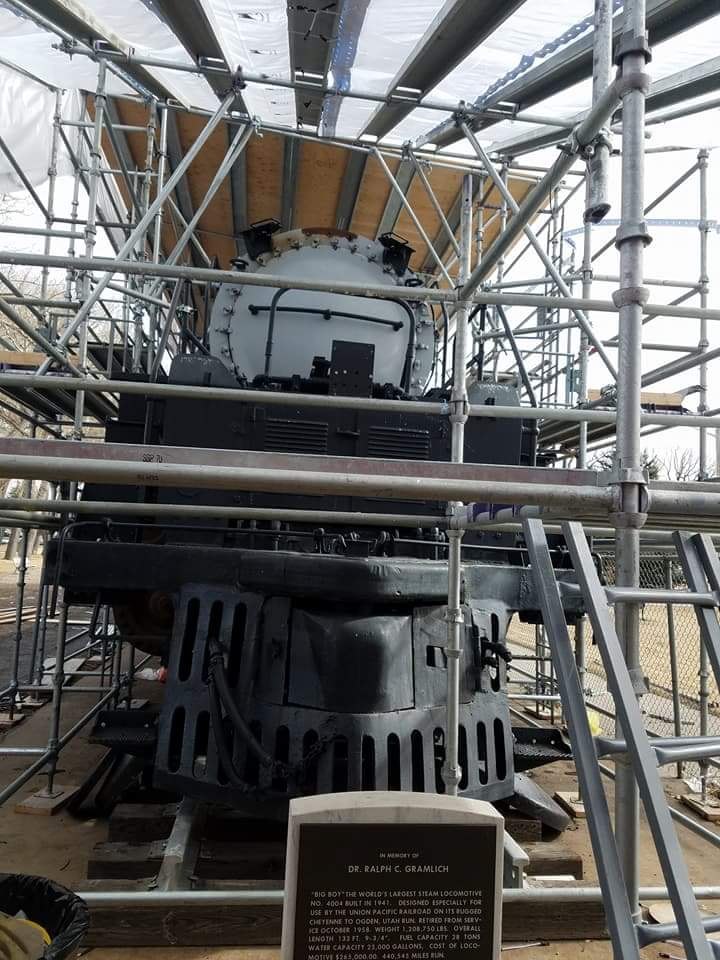

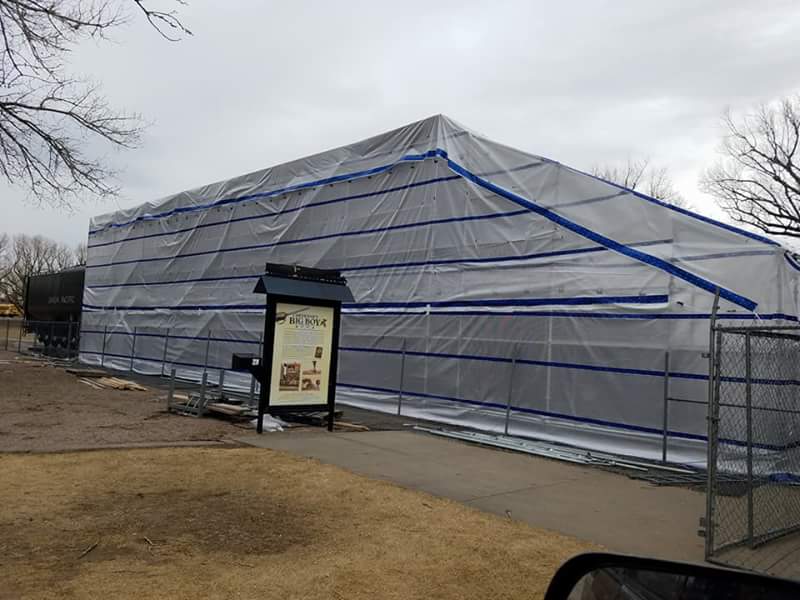

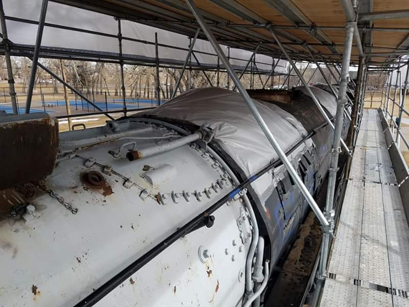

Meant to add more pictures apologies

I really appreciate any and all updates on the care and preservation of these beautiful machines. Thank you for getting the shots and posting.

No Problem Richard, i am project manager for this job so plenty more photos to follow

Has it been sitting all these years with lagging still in place? That can't be good.

So what are the plans for the replacement?
I've seen various approaches, including wood spacers as well as simply removing the jacketing.
It doesn't seem like putting on new lagging would be needed, and on a non-operational locomotive, all that does is collect moisture and hold it against the boiler.
How will that be addressed?

I think we will be welding spacers in place, we will decide once the jacket is off how we proceed from there. so far the insulation is conpletely dry as was the 2000lbs of sand removed from the sand domes.

joe6167 wrote:
Mike
Mike, you can use plastic wood spacers, I think that is what was used on CNR 6167. CNR 6213 used cedar (I think) bank in 1985 - or any wood that can resist rotting.
Welding, to the boiler shell? Wouldn't each weld be viewed as a pit if and when the boiler was surveyed for return to operation?
There has been long debate about what to replace lagging with on a display engine. The idea is to space the jacket away with something to allow air to circulate, so that water isn't held in close proximity to the steel and cause rust pitting. Some people have suggested wood blocks, but it would seem to me these have the exact same problem; if the new jacket leaks (it will, in time) the blocks will get wet, and hold moisture against the steel, same as the lagging. I should think cedar would be one of the worst choices, in that it contains a lot of tannin, which is corrosive to steel. Be a real shame to strip the boiler in fifty years and find a pattern of pitted patches that match the locations of the spacer blocks. Plastic lumber might be better, but would be better yet if most the contact surface was routed away, leaving just little feet, which would promote both drainage and air circulation, but sounds like a lot of work.
I have seen one job that was done using lengths of PVC pipe wired to the boiler on about 6" centers. The round pipe has the advantage of minimal contact area, but the continuous lengths would seem to impede air circulation.
I have often wondered if concrete re-bar bolsters (supports) wouldn't be a good choice.
These are available in heights from 3/4" to well over anything one would need in 1/4" increments, so should be able to be matched to the original lagging thickness. They could be fastened in place by tying them to stainless steel wire hoops looped around the boiler, same as the original lagging was fastened. They are available in plain steel, galvanized, or stainless steel. I have no idea how cost effective they would be, but seem to be the perfect solution.
I am thinking that the "upper level" bolsters, which have three longitudinal members, would be the strongest and easiest to work with, but the version with only one long member and bent metal feet are likely cheaper and may be workable. Below is the link to the complete Dayton Superior catalog; there are also other suppliers of similar products.
http://www.daytonsuperior.com/docs/default-source/handbooks/bar-support-handbook.pdf?sfvrsn=6dffd560_34
Not unless the welder got completely carried away with what he was doing. Should only require tack welds.
The likelihood of this locomotive ever being returned to service ranks right up there with the one in the park in Omaha, in terms of difficulty and expense to get either of them anywhere near live rail again. There are far better (easier and cheaper) ones to get back onto live rail than either of these two.
