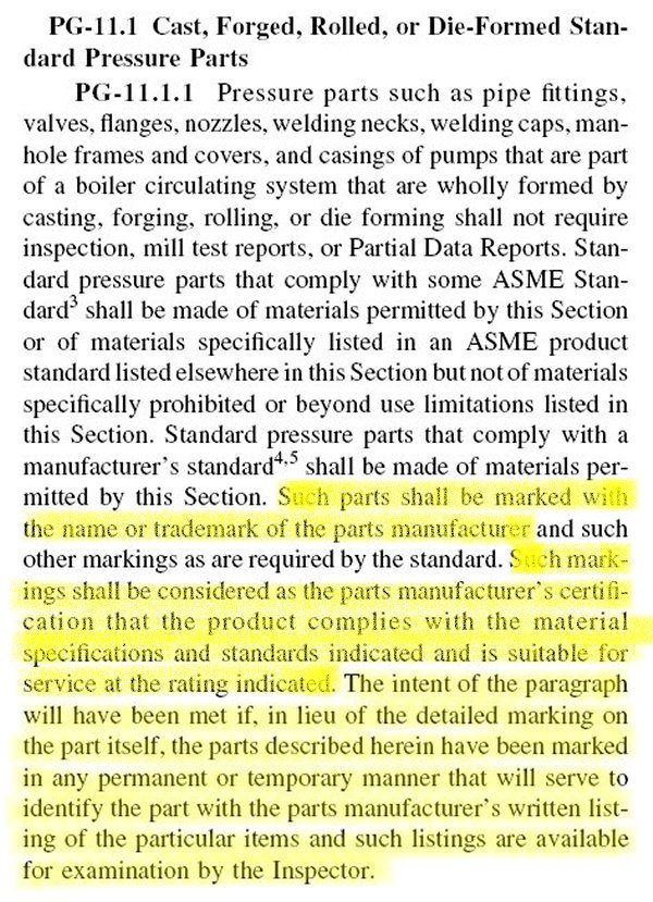

Does everybody in the USA engrave material specs into their staybolts?

I am interested to see responses to this. Is there a difference in material tracking requirements between doing a repair vs. new build?

Wish I had an answer Ed as I am curious as well. I know usually you stamp info on sheets and record it. I would think that you would stamp and record anything that was considered part of the boiler. But again I am thinking boiler repair/patches and have never seen a newly fabricated locomotive boiler. I have not seen studs, flexible staybolt caps, pipe fittings or secondary attachments numbered. All the material info is recorded with certification. If the parts were not new I might think part numbers? Regardless doesn't hurt anything? Maybe is this a ASME thing on newly constructed boilers? Hopefully someone will chime in. I think this boiler project is kind of exciting. Am real curious to see the finished project as well as further construction along the way. I like this kind of stuff.

Most US specialty steam locomotive boiler parts suppliers do. For decades I have been in shops, seeing bins filled with hundreds of caps, sleeves, etc. with hand engraved heat numbers.
A few, more Code literate suppliers follow the requirements of PG-11.1 for maintaining Code material traceability. Northwest Staybolt Company stamps a 1/4" circle N in on their products. The official delivery receipt and MTRs are included in the shipping container. NBIC repairs invoke ASME material identity requirements.
