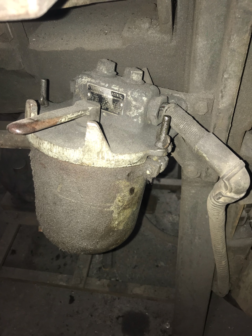

A friend of mine is working on an old sheet metal roler. The switch is a large ge switch that is oil filled. We can't find any info on what kind of oil should be in this switch. Anybody know? Machine is probably 1940's or 50's.

Send pictures of it, both the outside and, if possible, the visible accessible parts of the inside.

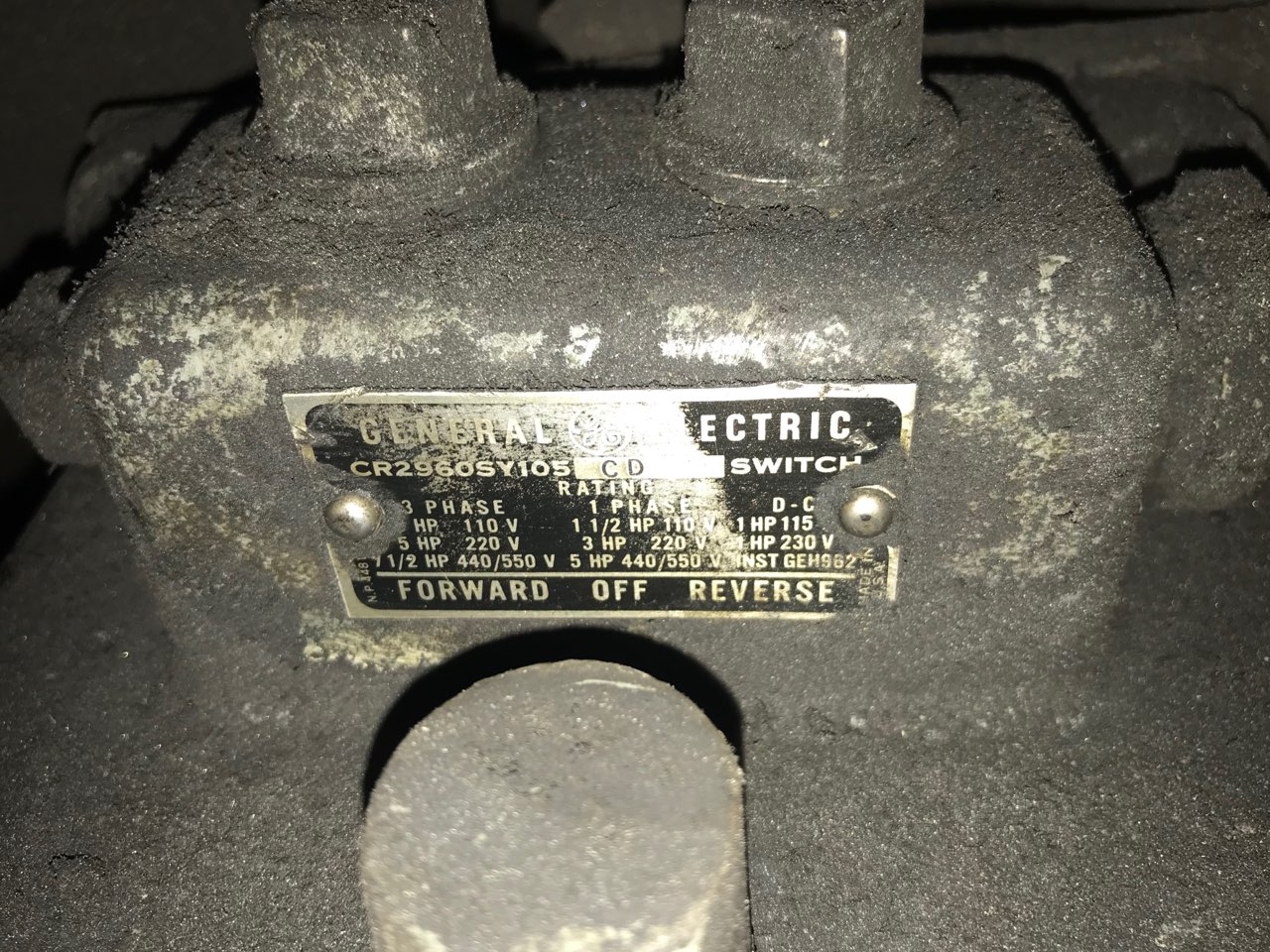

I believe the machine is still being used in production. Not so much being cheap, but the old "if it ain't broke, don't fix it" applies here. Same reason my 1951 South Bend lathe has the same switch it was sold new with. Just like the lathe, the switch is over built. I'm sure replacing the switch would not be an issue if it is justifiable, which sounds like it almost is at this point. We were curious more than anything. Neither of us had seen anything like it, and nobody we talked to locally knows.

Not to be argumentative, but my background is EDM, where you can actually see what is happening in the tank, and even at a couple of amps, the burn sparkles away under the oil, and the bubbles come up. It's likely not oil vapor; I believe the arc actually destroys the oil, leaving carbon in the tank, and hydrogen to bubble out. I do know that if surface flushing and the flush volume is inadequate to cover the arc, you get neat little flames that go poof, poof in time with the ram cycle. Not good, because these can eventually start the tank on fire. Never had it happen, never want to.
But the fact remains that the arc is hot enough to locally vaporize the oil, but the surrounding oil keeps air away, and I suppose captures all the ions that cause flash-overs. It appears this switch is rated 5 HP at 220VAC, and is arranged to "plug reverse" the motor. I bet that draws some amps.

Nowhere near sufficient rating, unless the "oil" switch is seriously oversize. The plate in the photo shows it rated 5HP at 220 V 3 Ph., 7.5 HP at 440 V. 3 Ph. The largest motor Bridgeport ever offered was 2HP, unless you count the monster Series II machines Textron offered for a time; those were 4HP, but I think they used contactors to reverse, not a drum switch.
I don't think I'd want to plug reverse a 5 HP motor with the silly little switch on my Bridgeport.

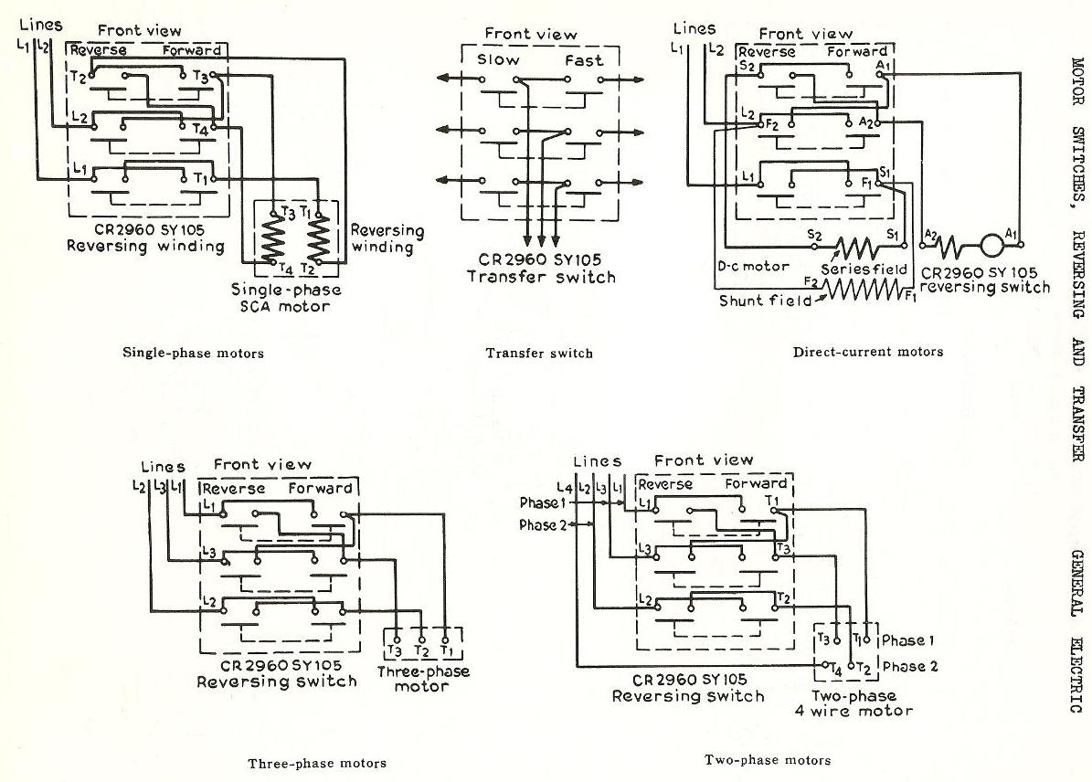

Transformer Oil (the same “stuff” used in submersible electric motor pumps etc.) will work just fine.
For reference, here’s the various connection diagrams for the General Electric CR2960SY105 switch.
John
File comment: CONNECTION DIAGRAMS FOR GE SWITCH
CR2960SY105
