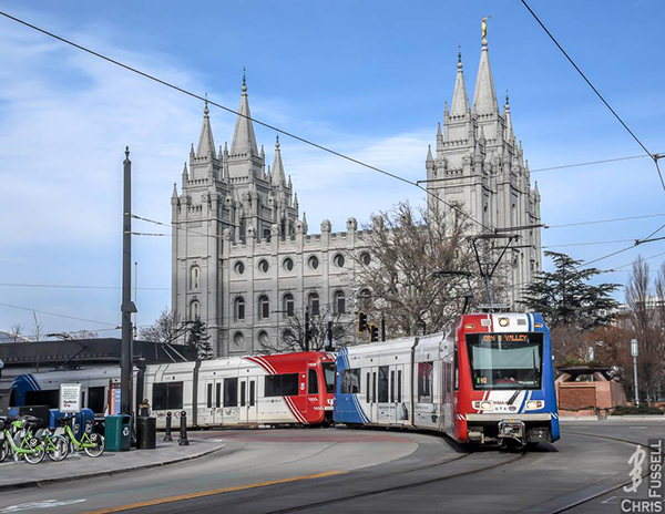

Systems that normally experience ice have shrouds on wires (used on Portland's MAX) and light-rail vehicles equipped with two pantographs instead of one. The extra pantograph is dedicated to cutting ice since it has grooves in it like a nail file (whereas the normal pan is smooth for maximum contact with wire), and those are only raised when needed. Here's a pic of Salt Lake City's TRAX from several days ago with the extra pans raised.

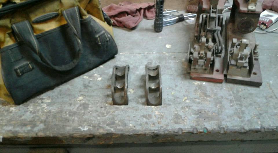

Speaking of McKinney avenues ice shoes; Here is a picture of our Ice Cutters. Not good to use them non stop since they don't lubricate the wire, its best to use them on only a couple of cars and keep carbon sliders on the other cars so the line stays slick.

These are the same as Toronto's ice cutters meant for a J-6 trolley harp and are a bolt on replacement for the carbon slider shoe. There is also a sleet cutter that looks much the same but is solid cast iron with no slots and is meant for light coatings of ice or sleet on the contact wire. Both types require monitoring so that they are removed once the sleet or ice has been cleared.
