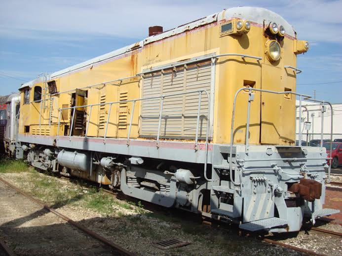

Hello, as the RYPN community may be commonly aware I currently am engaged in a potential project to preserve and restore AC&Y 505, the last built FM H20-44. Earlier this year I was asked by some members to pursue forming a non-profit 501c3 organization that would be able to not only maintain the engine but preserve Fairbanks Morse history as well. As of today that process is still ongoing with some new hope just around the corner. In the meanwhile I'm questioned to wonder if there is a existing group with similar goals or if I'd have to start from the ground up. If that is the case I'd like to ask if there are any passionate FM fans who'd be willing to assist in such an endeavor perhaps interested in saving the last piece of Buckeye FM history.

I have heard stories about these flame incidents myself but have never had the experience of seeing one in person. On average how would you describe the routine maintenance of an FM reportedly I'd been warned pursuing the project solely for this reason. Reports from former MLW staff who I've been able to speak with complained of their complexity and unfamiliarity to anything they'd worked on previously. Honestly never touching an engine in my life would it be something easy to get used to or more of a struggle in your opinion? Otherwise I look forward to new progress in 2016 and hopefully we'll get some goals off the ground,
