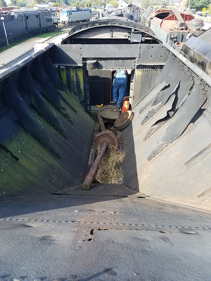

The pistons were removed when the locomotive was moved to the museum about 50 years ago. It arrived with the main rods and crossheads in place, and the pistons were in the tender. The crosshead rusted fast when water entered through the lubrication points atop the crosshead guide.

We could lube 757's pistons and rods, but would have to go to Scranton to do it!
759's pistons and rods are in the tender, happily living out their days.
