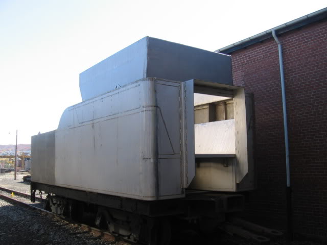

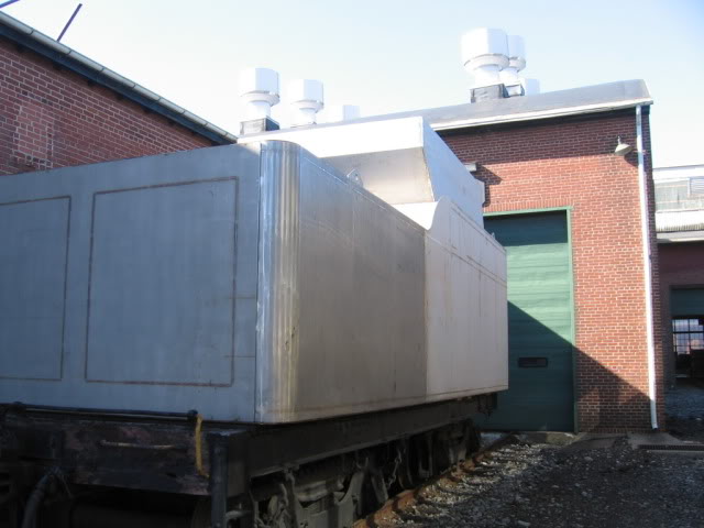

The infamous stainless steel tender

I don't get "the infamous stainless steel tender" remark. I'd think that would be progressive and smart.
Here are some pictures from my several trips to Scranton. I need to refer to the study of each of the Steamtown locomotives to get further information on 3377. Seems I recall there being a plan to return 3254's strongest parts to 3377, from where many had come. Keeping the 3254 as a static display wouldn't be a bad fate, and returning the silent Mike to service is a very good idea.
Please, let's stay on the topic of this one changeover 3254 to 3377, and not get off on other Steamtown locomotives.
