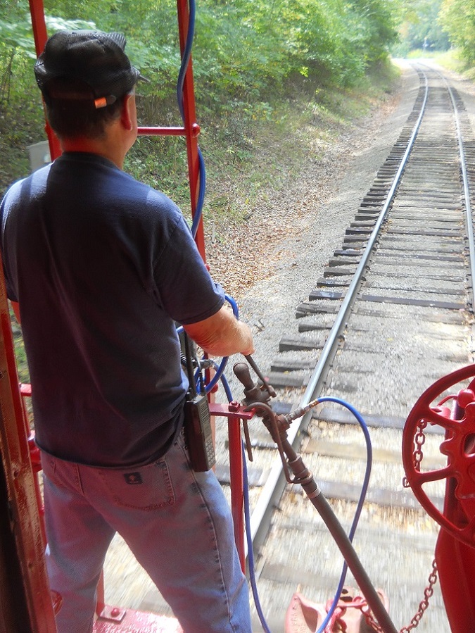

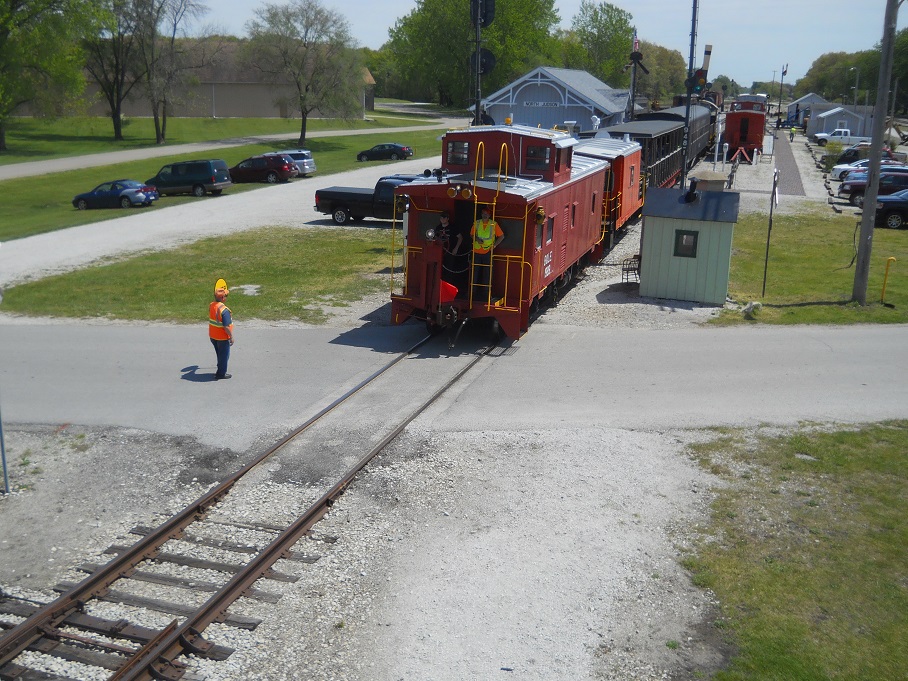

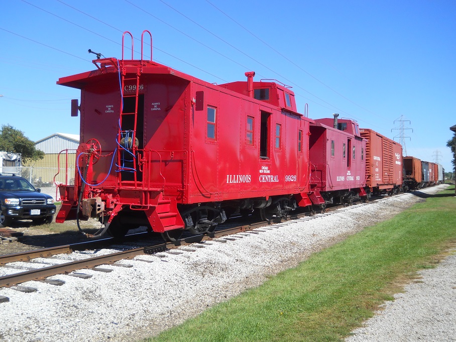

Figuring that "A picture is worth a thousand words", I thought I'd add a few to this discussion.
The first shot is of Illinois Central caboose #9926 as set up to lead one of the Monticello Railway Museum's trains from the museum site in to Monticello in September of 2015. Note the air horn on the roof and the tail hose.
The second photo shows the same caboose in September of 2017 with conductor Dennis Slone on the platform as the train pushes toward Monticello. Dennis has his hand on the tail hose in case a stop is needed.
Finally, although the Hoosier Valley Railroad Museum does not use a tail hose, the last photo shows the rear platform of Bessemer & Lake Erie caboose #1989 with the various lights and the air horns mounted on the roof, as the train backs away from the museums North Judson depot on its way to English Lake.
