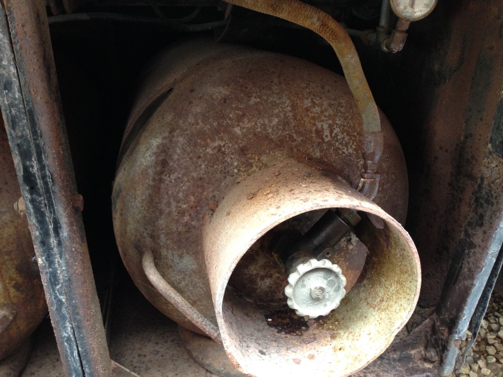

Recently went to have one of the standard 100 lb coach propane tanks filled. These are for the Waukesha Enginator/Ice Engine, stove, etc. The tanks lay in the propane locker mostly horizontal.
The propane company told me they could not get an exact valve/snorkel replacement. The issue they had was if somebody fabricated one on their own, for example, and it failed, they would be liable. They declined to fill the tank.
Anyone know of a solution?
Warren

File comment: 100 lb propane tank

Probably your best (easiest) solution would be to change the tanks to the style tanks they use on forklifts and manlifts. They are also a liquid dispensing, horizontal set-up for running engines, and are commonly available. I think they are 50lb, not sure if there is a larger version that is readily available. You will most likely also have to change the fitting (and maybe the flex line, it almost looks like it is time).

Author:  warren032 [ Fri Oct 20, 2017 5:22 pm ]
Post subject:  Re: Valves for Coach Propane Tanks
Thank you for the input! The propane company gave me a 50 lb horizontal tank they didn't want. So I'm working on that.
The pigtails (hoses) were replaced, of course (old pic). Vendor also told me only requirement on the tank is a "visual" inspection for obvious damage and a little rust won't hurt, but best to be clean.

Niles Canyon Railway uses Waukesha 100-lb-capacity propane tanks to supply the kitchen stove in S.P. 1975 "All Day Lunch" car, and the kitchen stove and water heater in S.P. 10040 dining car.
Waukesha 100-lb-capacity propane tanks are much thicker and sturdier than an DOT-rated propane tanks. Kamp Propane in Hayward, CA is our local industrial propane distributor. We have them hydro-test and certify the Waukesha propane tanks periodically. Kamp advised us that the Waukesha tanks are much thicker and studier than even the "heavy duty" DOT-rated tanks they sell. They recently refilled one of our Waukesha tanks that was built in 1935. (They had hydro-tested, inspected, painted, and certified it a few years ago.) So age and surface rust are not necessarily a problem.
Tanks with serious dents cannot be recertified.
Waukesha tank valves have a J-shaped dip tube because they are designed to be used at about a 15-degree angle from horizontal. See attached PDF files.
Waukesha_propane_tank_semi-horizontal_position_3.pdf [118.72 KiB]
Downloaded 769 times
The measurements of the dip tube were made on new (never installed in a Waukesha tank) spare valves found in the former S.P. business car "S.P. 143 "Santa Rosa".
Older Waukesha tank valves do not have a vent valve on the side of the main valve. Apparently these tanks must have been filled while they on a scale to weigh them. Unless you can find a propane vendor who is willing to use the weighing method, these tanks can no longer be refilled.
Newer Waukesha tank valves have a vent valve or "bleeder valve" (this may not be the technically correct terminology) on the side of the main valve, as shown in my sketch "Sherwood 3250A...". Our local propane vendors have no problem refilling these tanks.
If the tank is vertical when it is refilled, you will only get it about 70%-75% full before the vent valve starts spewing liquid propane, which indicates that the tank is "full". Laying the tank on a piece of RR tie, so it's in the 15-degree-from-horizontal position (more or less), with the correct side up (this is stamped on the tank), allows the tank to be completely filled.
What does wear out [and start to leak], and must eventually be replaced, are
(1) hoses - get new ones, don't ever use old iffy hoses!
(2) regulators and shutoff valves - the molded rubber gaskets & diaphragms are no longer available.
Modern heavy-duty replacement valves and regulators are available. Be sure to work with a propane system expert to get the right ones.
If you really need a lot of propane, Kamp Propane in Hayward, CA has two sets of much more modern 200(?)-gallon dual propane tanks in frames that clearly were originally installed under a railroad car. I don't know the rest of their history. I suspect they were on a car that used a lot of propane for Waukesha Ice Engines (propane-driven air conditioning compressors) and Waukesha engineators (propane-driven 32VDC generators). These propane tank units in very good condition. They still have some propane in them. We had no foreseeable use for these, and our hazmat inspector pointed out that propane tanks are a potential bomb in a brushfire, so we gave them to Kamp Propane for disposal. More than a year later, they're still on Kamp's back lot. Contact me if you're interested in them.

Thank you everyone for the propane tank updates. I think the trick will be to purchase new Sherwood valves and fit them with the "J" snorkel tubes in a way that the propane vendor will accept.
Yes the pigtail hoses have been replaced with new ones. I will keep you guys posted!
