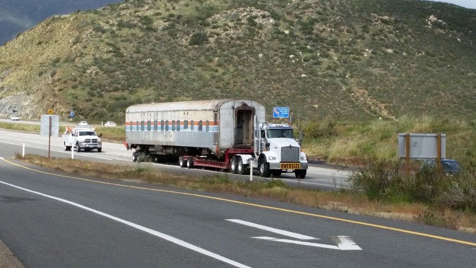

Here's how Imperial Bird, a 1942 Pullman sleeper
was moved form the Los Angeles area to Campo, CA (50 miles east of San Diego, including up a 6% grade. One end was on a low boy flat bed, the other end on a dolly. this move was in the Spring of 2016. The wheel trucks came on a separate low boy.
