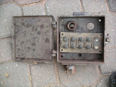

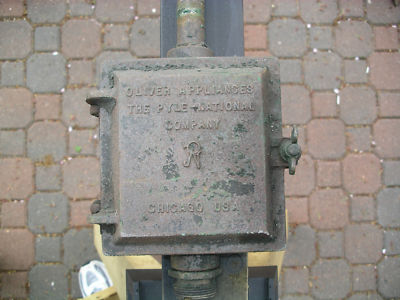

Hi All
I am looking for information on a Pyle National 5 wire junction box and a fuse box so I can model them in 1/8 scale. Detailed pictures, measurements, drawings would work.
Thanks
Tim

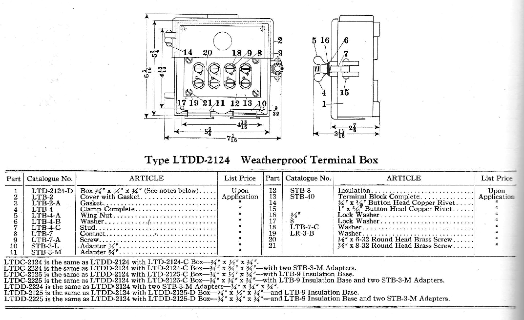

Here's the catalogue drawing from Catalogue 210. LTDD2125 is the five wire version. Same box.
G.

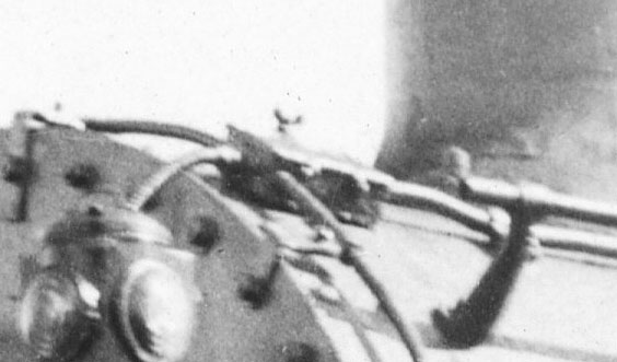

Here is the best picture I have of the one I am trying to model.
Tim

Tim - Are you sure it's 5 terminal box? The engine pic looks more like a TCAC-3312 or -2212 with hubs A,C,L, & R used.
IMG_20170913_0001 150dpi.pdf [511.63 KiB]
Downloaded 1385 times
G.

Tim - If you have a BOM from the engine builder or RR, that's likely what was on the engine - at least as original equipment.
I suggested the TCAC-3312 because in the engine picture it looks more rectangular to me, the cover and top hub look more like the TCAC illustration in the catalogue, and the installation fits the TCAC stock configurations.
Of course the TCAC-3312 is also a standard 12-wire box, which is unnecessary for the pictured installation, and I missed a page in the catalogue. It now appears that it was a STBC-335, which is basically a TCAC box with a LTDD-style screw terminal block. The STBC-335 is the same size as the TCAC-3312 and is a 5 wire box, so I'd say that's it unless there's something different in a catalogue closer to your engine's build date.
I also noticed that your original color pics are of two different boxes - the lower (open box) would be a modified LTDD, the upper (closed box) looks like a LTB.

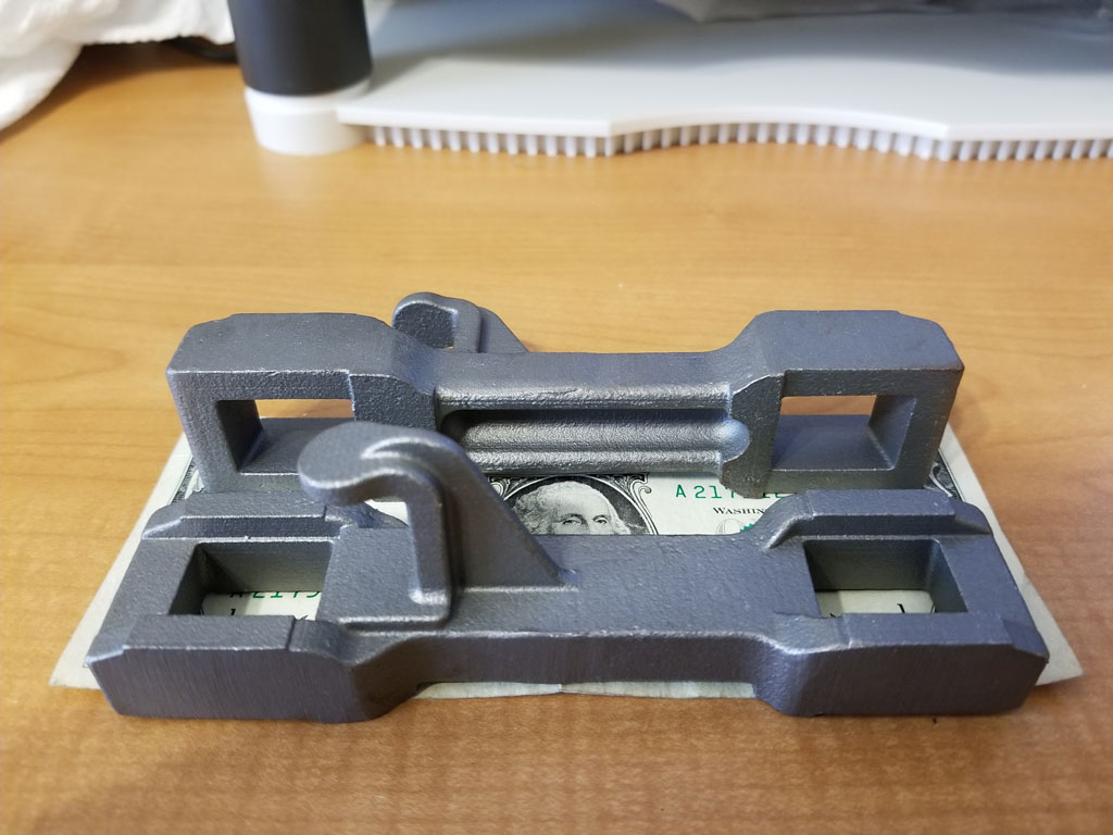

Yes I am going to try to get the details correct. Here is a picture of my pedestal binders. They are cast in steel. Do to maintenance issues down the road I am not doing the Franklin wedges.
Tim

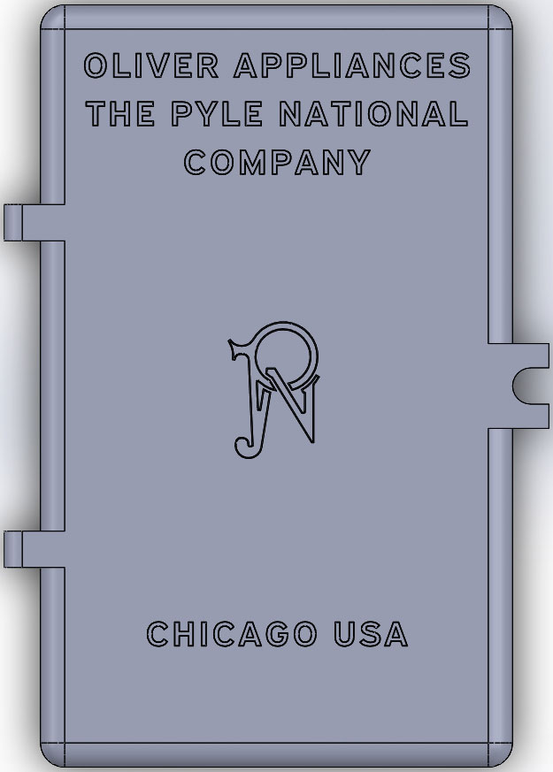

Here is a picture of the TCAC-2212 lid. Let me know what you think
Thanks
Tim
