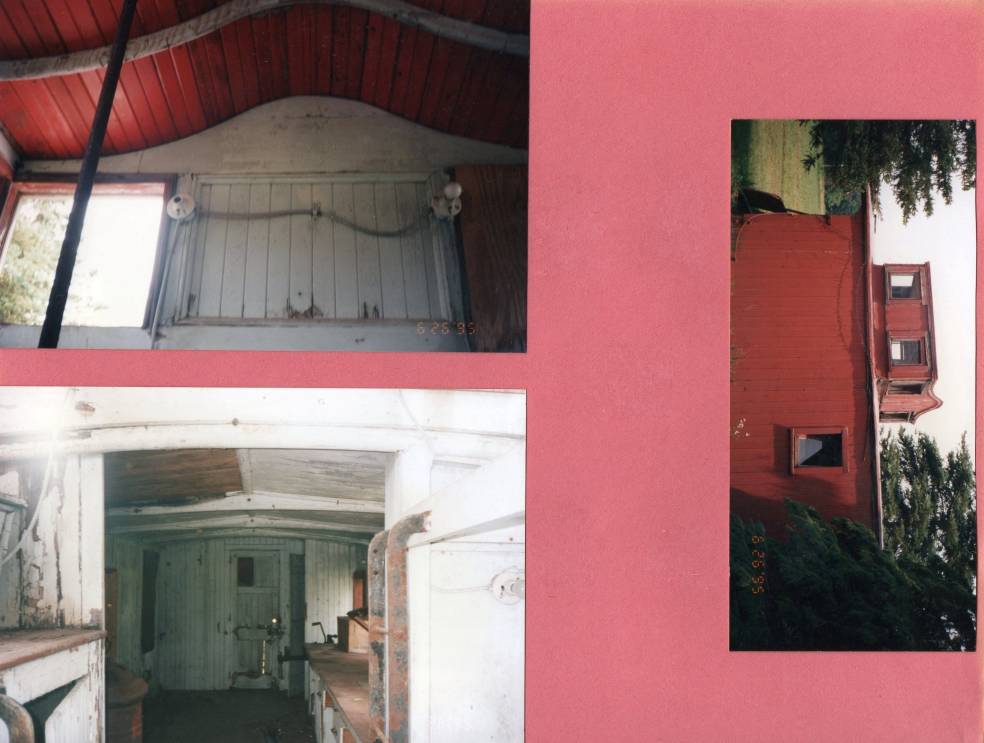

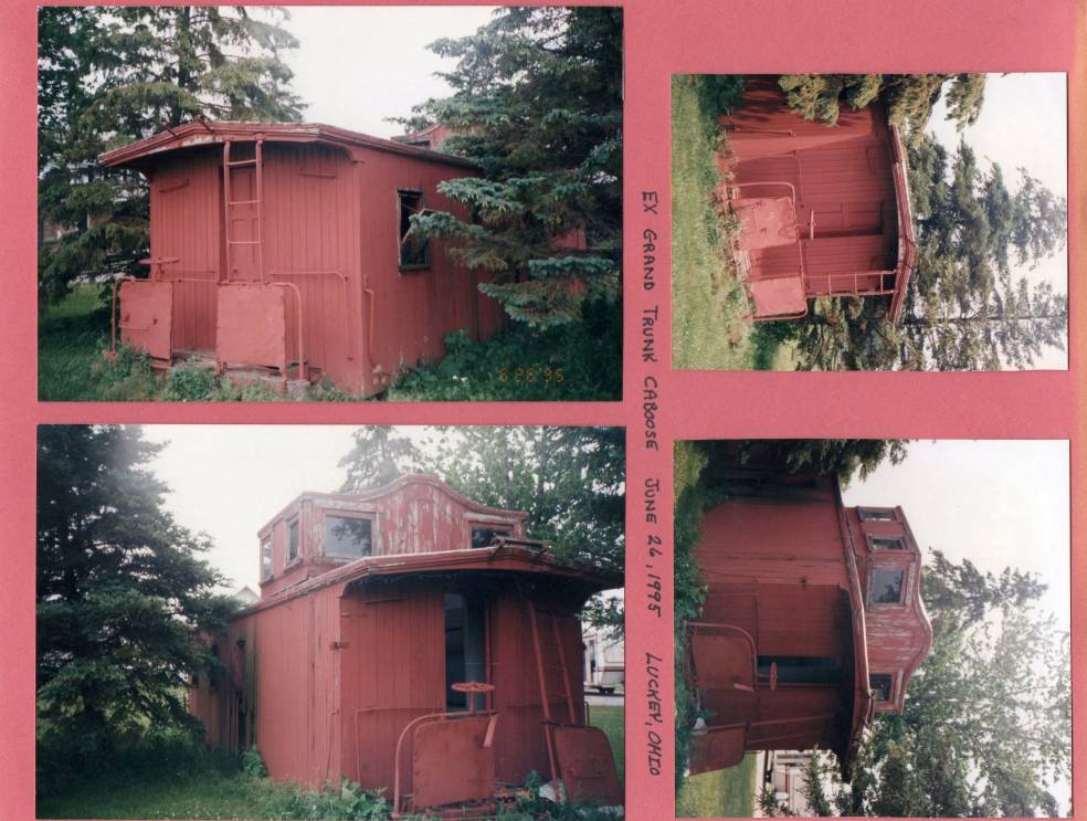

Years ago in 1995 in the classified ad pages in the back of the old LR&P magazine wich i used to get there were several issues where a person in North Muskegon, MI was selling a old restored wood Grand Trunk RR caboose wich had this same type of cupola roof.In the ad they described it "With roller coaster cupola roof". I still have the magazines with the ad in them.Is that the correct name for those type of cupola roofs or is that just another descriptive name used for them?
At the time on June 26th 1995 a friend told me about a old wood caboose he saw on a farm near Luckey,Ohio in Wood County while on a drive with his wife.He had stopped by to look at the caboose took pictures of it and the owner said it was available for free if anybody wanted it and would move it as it needed work and that he didn't have the time or desire to do so himself.A few weeks later i went there with my friend to look at the caboose,i had just bought a caboose a few months prior to that so i wasn't really in the game for getting another but wanted to see this gem my friend was raving about with a odd cupola roof.
When we pulled in to look at it i was in awe as i had never seen a caboose like it before with that type of cupola roof.I thought it was really neat and the general overall condition wasn't all that bad for a old wood caboose.It did need some work but it really wasn't bad compared to some of the stuff you see now that's been rotting away for the past 30 years.It had no trucks,was blocked up but had sunk to the ground over the years.Some wood needed replacing but it looked pretty solid.All the grab irons,brake wheel,end ladders and some other hardware remained.Some windows remained,a few were missing and the old wood doors were still intact.
The inside was still somewhat original other than a work bench had been constructed along one side wall past the cupola area and somebody had put in some interior lighting at one time.It needed a good cleaning inside as raccoons had been inhabiting it but basically it wasn't a bad old wood caboose.The owner didn't know the RR history.I don't know whatever become of the caboose as my friend told me he drove by there several years later and it was gone.I assumed it was a old Grand Trunk caboose after seeing the ad in LR&P for one like it.Maybe it was from some other RR?
Attached are some photo's my friend took of that old caboose at Luckey, Ohio with the roller coaster cupola roof.Anyone know if this caboose was lucky enough to be rescued and saved?
