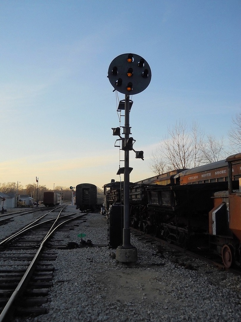

Some PRR CPL's still exist of course, at museums. Pictured herein is our example at the Hoosier Valley Railroad Museum. The signal head is controlled by the museums track circuits with the lower signal being used when the switch shown is thrown for the storage track. Perhaps not exactly what the Pennsy had in mind, but it works well for HVRM.
